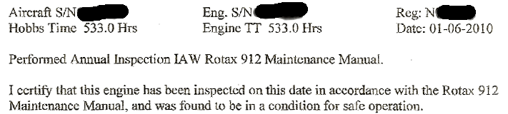

Here are a couple of examples of what I see on a too regular basis:
This is an entry in the logbook for an Annual Condition inspection minus the A&P’s signature;
Here is the Annual Condition inspection for a Rotax engine minus the A&P’s signature:
Some short logbook entries might be barley legal, but they aren’t doing you any good and it’s just lazy not to fill out a proper logbook entry. Paperwork usually takes me 2-3 hours per plane. Just as important have them make entries legible if hand written so anyone can read them. If they can’t, printing them on a computer with a sticky label works wonders.

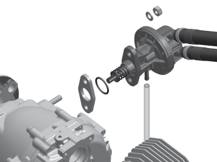

Well, the pulse line to the fuel pump has a somewhat short nipple on the engine and the hose clamp hung past the end of the nipple just enough that all those little "tweaks" had constricted the I.D of the hose to about half of what it was originally. Still got enough pressure to run the engine O.K. in level flight at reduced power, but not enough for full throttle in a climb.
Replaced the pulse line and all was good again.
Rotax-Owner Addendum:
Rotax recommends the use of gear clamps, Rotax part # 938195 on fuel lines.
Excerpt from the 2 stroke installation manual showing fuel system diagram.
Excerpt from the 2 stroke Illustrated Parts Catalog showing fuel pump and components including the recommended Rotax gear clamps.

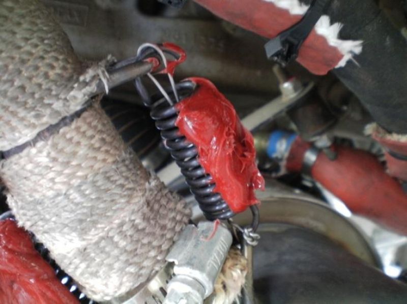

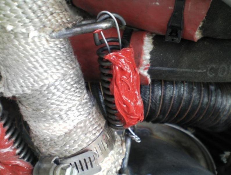

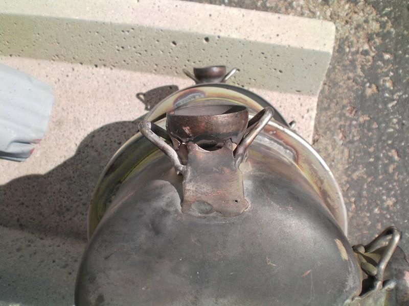

Let’s talk about the tension on your muffler exhaust springs. Too little?---Too much? Although there several types of exhaust and muffler setups out there, I’ll limit this article to the most common and that is where the exhaust spring holds the exhaust male outlet pipe into the female socket on top of the Rotax stock muffler. If you don’t have a stock Rotax muffler, but do use springs, then this article will still have significance for you.
What happens if there is not enough tension on our exhaust springs? The muffler will have excessive vibration and pulsation from the exhaust and cause the exhaust tube to hammer in its female socket. This will cause cracks, broken out pieces and the chaffing will eat away the edges of the exhaust pipe and socket and too little tension will cause hot exhaust gas leaks that might impinge on your hoses or wiring.
I just performed maintenance on a 912ULS with 375 hours where the female socket on top of the muffler was destroyed from too little spring tension which allowed the exhaust pulsations to hammer on the socket. Since we are talking about this exhaust socket, or joint, I should bring up that this needs periodic lubrication. Use copper anti seize on this joint to help prevent early failure. This is the same anti seize used in the gearbox assembly. (You may have even seen what you thought was brass metal particles in the oil the first time the engine oil was changed. It was, most likely, just this copper anti seize.) When there is too little spring tension the spring hooks will vibrate excessively and wear at the spring hook where it comes in contact with the loop welded on the exhaust tube and muffler. (See attached pictures)

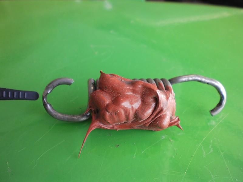

So, let's examine the solutions There are a few different types of springs available not to mention all the ones owners may buy at the local hardware store. I recommend springs approved by Rotax. So it may be hard to get the perfect tension addressed in this article so again, I will limit this discussion to just two types. (Pictures below are the two most common.) One is the Rotax spring part number, 938-795. The other one commonly seen is a stainless steel spring and is much heavier in construction. It isn't necessarily better, just different and the correct tension will prevent premature wear. The wrong tension can make any spring wear out or break in as little as 200 hours. If you use the heavy stainless steel spring an effective quick evaluation for the best tension is obtained when you can see a little daylight between the coils or you have enough room to insert your fingernail between coils easily. If you can't see any space, then the spring may not have enough tension. At least you will know that there is some tension on the spring if you see a little daylight and it won't be over stretched. The correct calculation, following Rotax’s maximum 10mm(.4â€) stretch would be calculated as follows: Each spring has approx. 11 coils but the first coil is zero leaving 10 potential spring gaps. If you have ten spaces between coils, and maximum stretch is 10mm(.4â€), your maximum allowed distance between coils is 1mm(0.039â€). Let’s call it 0.040†and use a feeler gauge to measure it, straight forward, simple!
Get back in your seats; we aren’t finished yet. We need to apply some high temperature RTV silicone. This helps prevent vibration from wearing on the spring and helps give it a little extra support. There are two ways to apply the RTV silicone. The least common and least desirable way is to fill the spring’s interior with the silicone. I don’t particularly like this because you need to safety-wire the spring and remove it at times and then it becomes a problem trying to get all the RTV out. The best, and most common way, is to lay a bead of the silicone from top to bottom on the outside of the spring. Here is where it was important to see a little daylight between coils because you want to work the silicone in between the coils as you apply your bead down the side. The bead should be at least 3/8â€- 1/2 inch wide and 3/16†– 1/4 inches tall. This gives the silicone some body and strength. Applying a pencil thin bead, or a line down a fully collapsed shut spring is close to worthless.
One last thing you should do is safety-wire those springs. Too many have gone through props on pushers. You can run the wire down through the center from welded loop to loop, or through the spring and back around the outside, but still through the welded loops. Do not make the safety wire tight. Leave a little play in it so it can move. It isn’t there to hold the exhaust together, but only keep the spring in place in case it comes off or breaks. If you make the wire tight the vibration will just wear through the wire quickly. My personal choice is to use .041 wire and not .032.
I have attached a couple of pictures to show what excessive wear will do to a heavy, stainless steel spring hook and a muffler socket. The red RTV silicone was applied well, but isn’t between the coils. There is a picture of the Rotax spring connected to the exhaust with the RTV silicone and safety wire already applied.
For readers reference I’ve attached page 43 of the Rotax installation Manual which states Rotax’s official technical position on proper muffler spring tension.

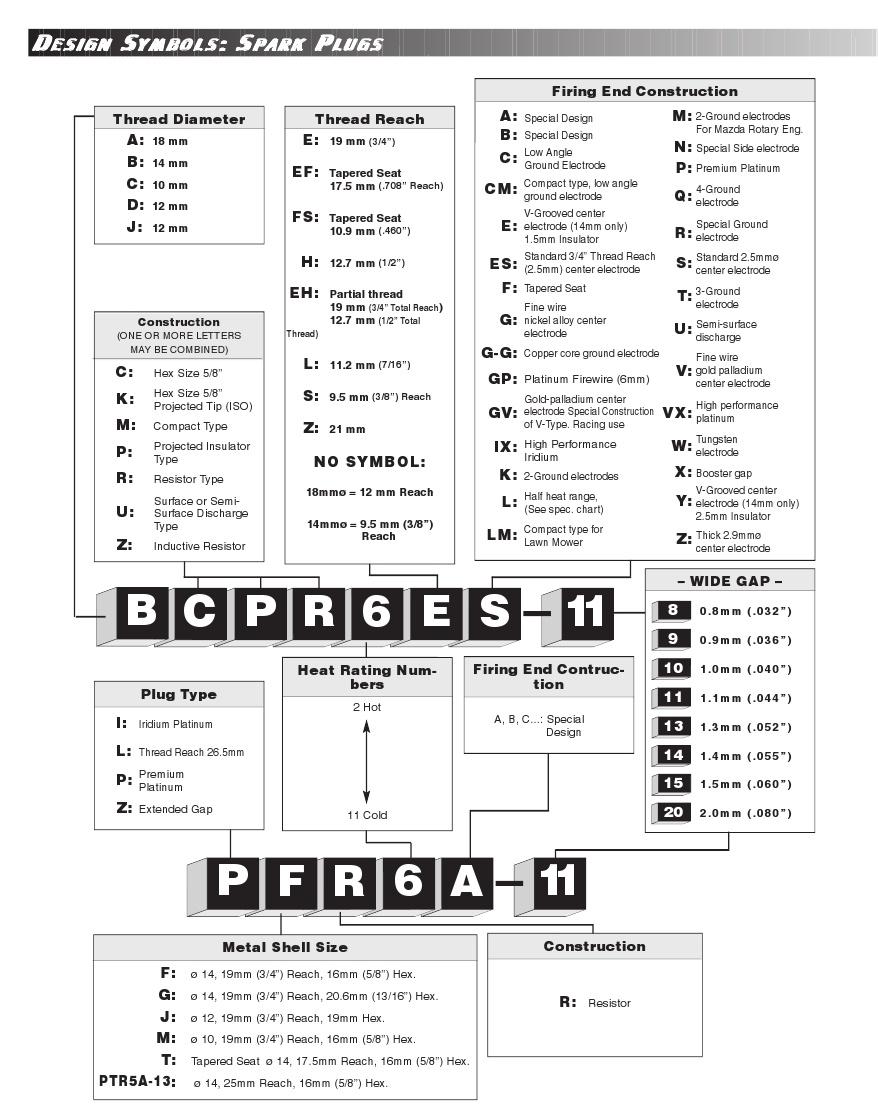

[h=3]Understanding the numbers on my spark plug?[/h]numbers.jpg

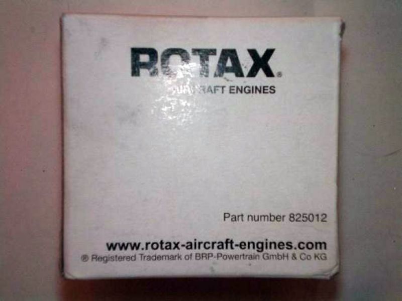

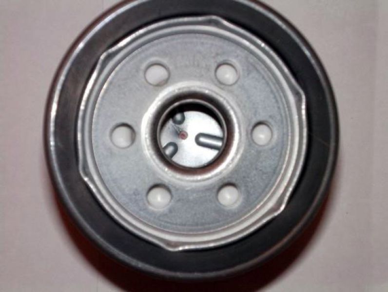

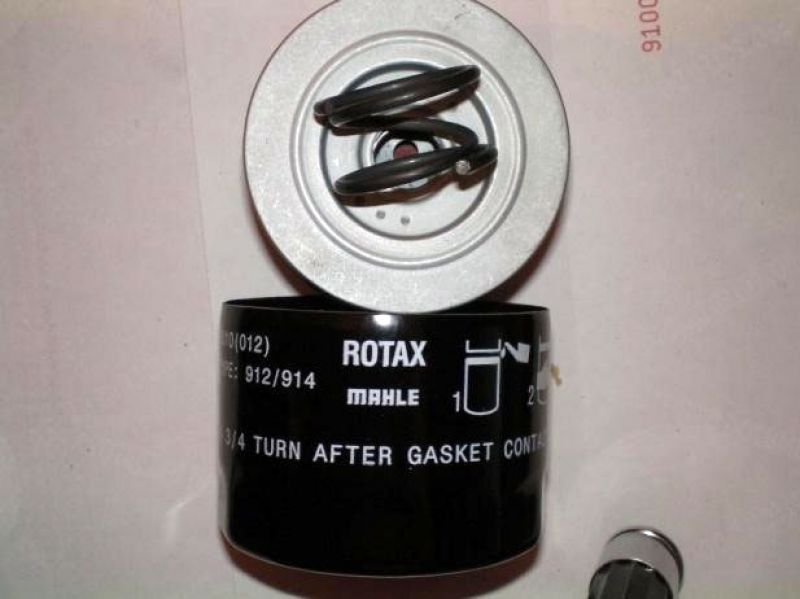

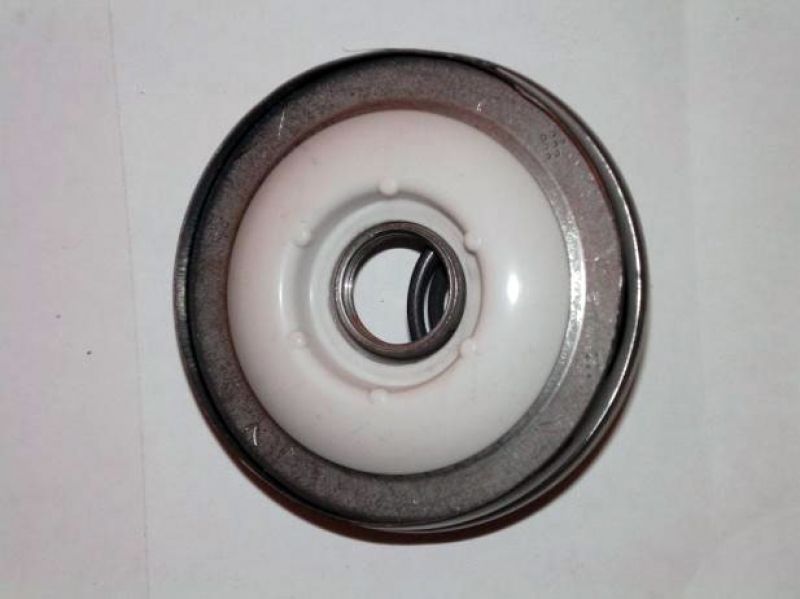

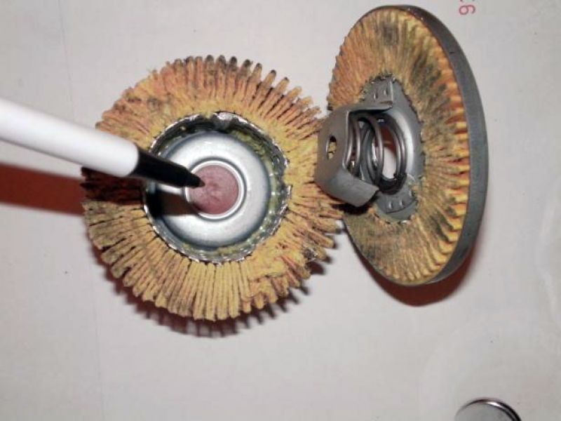

Rotax has a new addition to their parts inventory: the new Rotax oil filter. It’s manufactured by Mahle, part #825-010 (012) and made in Austria. Rotax took a look at all the different engine installations and I believe they thought it was time for a change and a change for the better it was. The new oil filter comes in an all white box verses the old filter box that was blue/white.
Related Videos are: Oil Filter Installation, Oil Change Procedure, Oil Level Check
It is slightly longer by 3.5mm or .138 in., but this is not where the changes stop by any means. Some changes were sweeping. For instance, some are specifically designed with the mounting of the oil tank in mind. This is important because we have a dry sump system and not a wet sump system . The white silicone drain-back preventer (valve) is improved with little or no oil being allowed to drain out of the filter while the engine just sits. This was designed for engine setups where the oil tank is mounted a bit too low, which prevents the oil from draining back into the tank and out of the filter and engine.

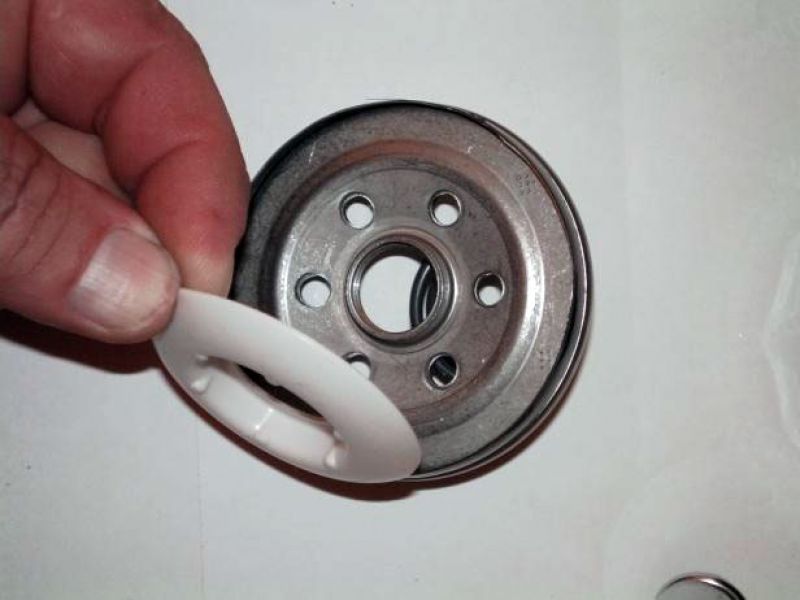

Another change was the addition of a “one way check valveâ€. This feature is for those oil tanks that are mounted too high above the recommended oil tank location. It keeps oil from draining out of the tank back down into the engine.

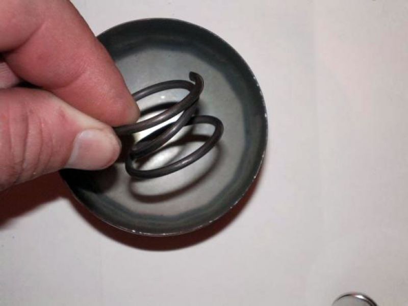

The next change is a new bypass pressure spring. The old filter used a piece of spring steel. This new oil filter has a smooth round edge spring so it doesn’t have any sharp edges to wear through the filter housing. The old bypass pressure was 1.1 bar or 16 psi. This new filter is 1.2 bar or 18 psi. This will stop some filters from opening for a second or two at start up. The old oil filter could be pre-filled with oil which made it easy, but with this filter you can’t pre-fill with oil and you must turn the prop to put oil into the filter before your first start after an oil change.
So you see Rotax has made some fairly big changes to the inside of the oil filter to better help its users deal with their different engine applications. I have attached several pictures so you may see what is actually on the inside. I swore I wouldn’t cut open a perfectly good filter and wait for a used one, but curiosity got the better of me. For the photography critics out there, no I didn’t quit my day job.
I hope this helps you to understand the new Rotax oil filter.

p_newpump.pngRotax has introduced a new fuel pump assembly for the ROTAX 912 series aircraft engines.
This new style pump does not mandate that old style pumps be changed, it is only an up-dated replacement part now available in spare parts and supplied with new engines.
The new fuel pump will be introduced on new engines manufactured from early May onward. Replacement fuel pumps will be available as spare parts with Rotax part numbers as follows:
Fuel pump with barbed hose fittings - Rotax part number 893110
Fuel pump with attached fire-sleeved hoses - Rotax part number 893114
The following will provide more information including photographs, diagrams and special installation considerations.
Details on the new fuel pump assembly can be found in the latest revision of Rotax Service Instruction SI-912-020/914-022 Revision 5. Specific serial numbers of engines which have the new fuel pump already installed during manufacturing can be found in chapter 73-00-00, section 4.1 of the Service Instruction. The Service Instruction document can be downloaded for all 912 series engines by clicking on the link below:
Some important considerations for this new style fuel pump assembly:
  • When installing the fuel pump, a new isolating flange (gasket) must be used.
    In addition, the new fuel pump requires an o-ring (part # 631870) between the
    fuel pump assembly and the isolating flange (part # 950228)
  • A "drainage line" must be attached to the bottom nipple fitting to accommodate
    potential overflowing fuel / oil in the event of internal pump diaphragm or seal
    failure. This drainage line must be routed to an appropriate area away from hot
    engine parts etc. It is important that the drainage line be routed to a ram air and
    vacuum free zone, it must NOT be routed into the slipstream. The drainage line
    must have a continuous slope downward and must be protected from blockage
    (e.g. formation of ice).
  • Maintenance requirements include inspection of the drainage line for damage
    including blockage.
  • The fuel pump cover assembly is held on with 7 screws. This is for assembly
    purposes only during manufacturing, the pump is not rebuild-able nor is it intended
    that it be disassembled for maintenance.
For more information on parts availability, installation or maintenance, please contact your nearest Distributor, Service Center or Repair Center.
