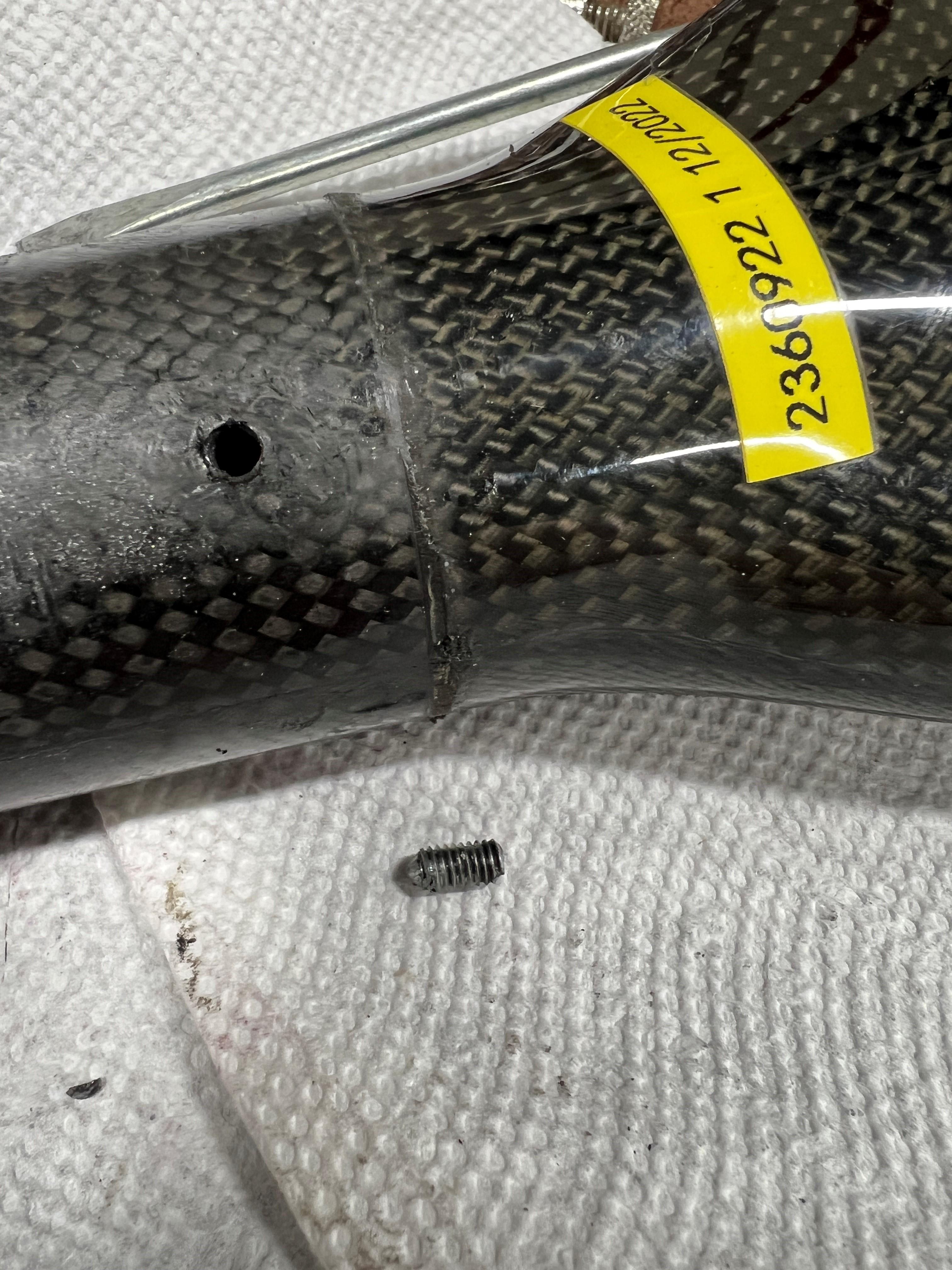

My Phoenix stick was vibrating around 3300 rpm - 3500 rpm.  Later in the day stick vibrating @ 45-4800 rpm. When we landed later noticed bugs on one blade leading edge and not the other. Any thoughts?

turned out to be the set screw on one of the blades had sheared off causing one blade to over flatten.
