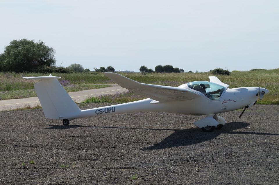

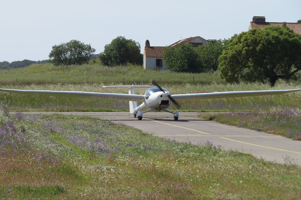

Hi John
I´ve one whith a woodcomp 160/Varia. It`s feathered and as great for soaring!
Regards
Rui
