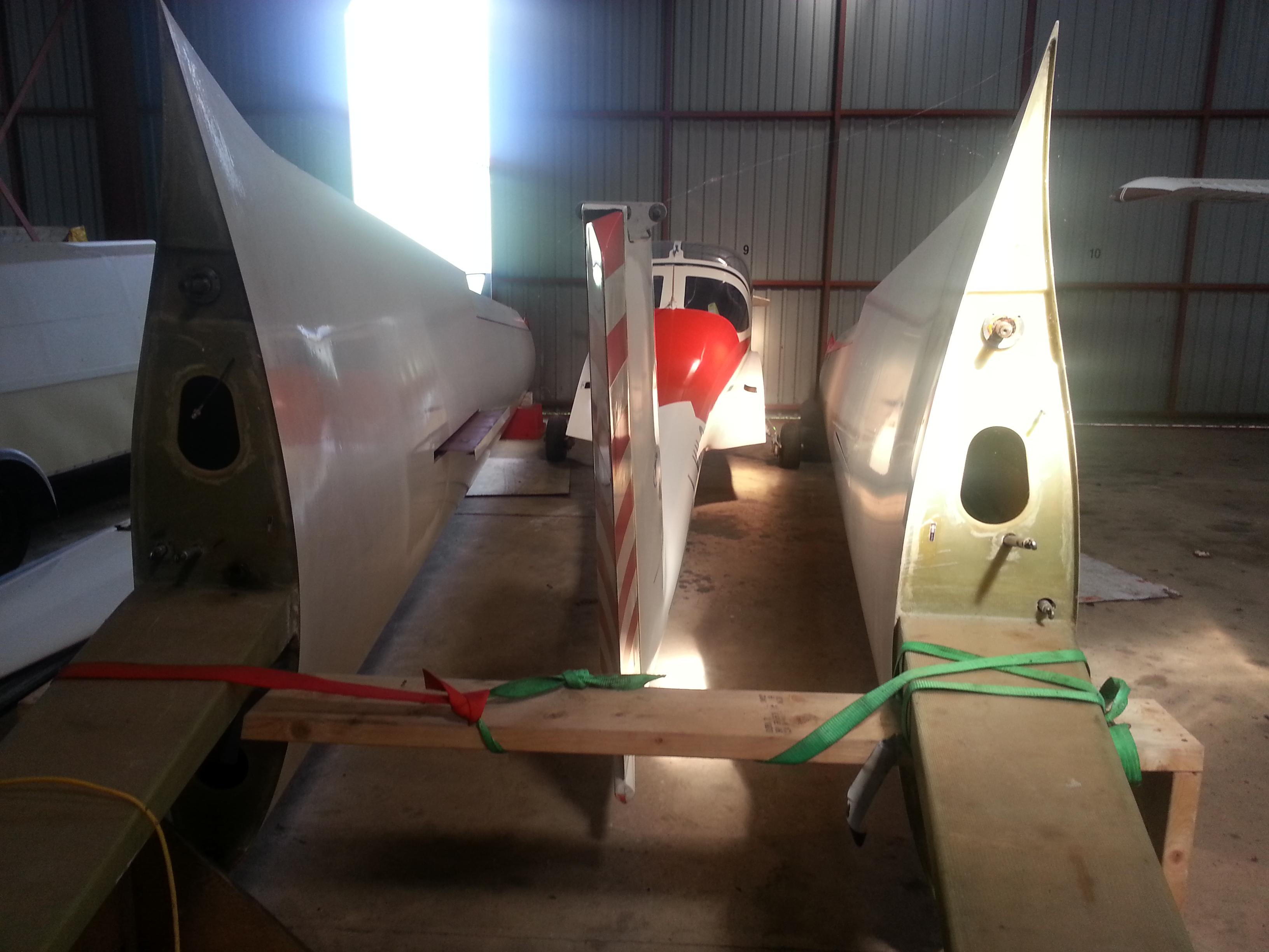

The wings just need to be suported enough to no scratch things. I used mattresses as pading. I also tied them to the inner walls of a 26 foot U haul.
be carefull of the pitot tube.

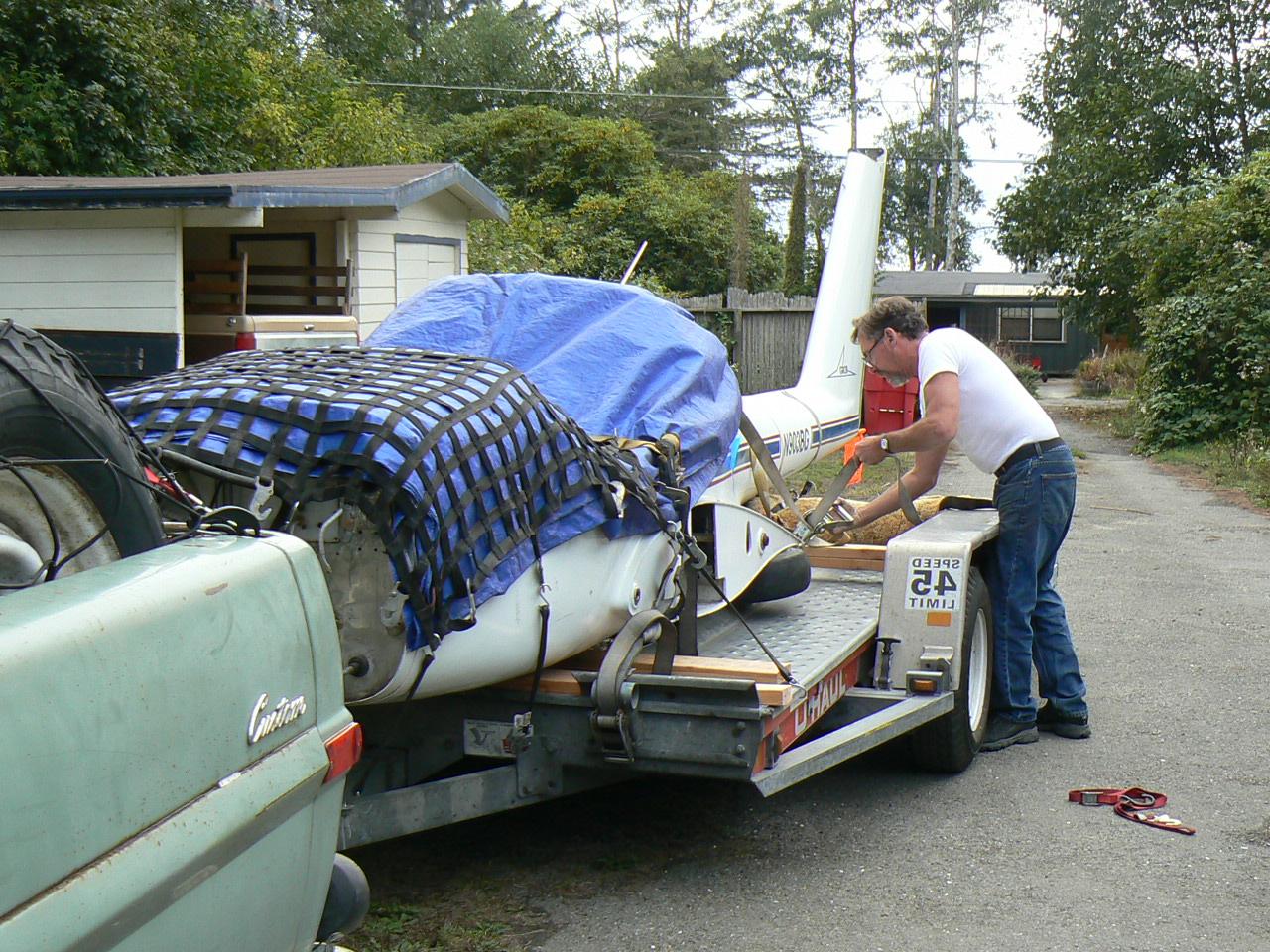

The fuselage was easy. with no wheels it rode on a mattress. with wheels it was easier. just tie it down.

Thanks Bill. Did you have the wings laid down flat. The flight manual refers to supporting them at the wing spar and at the aileron - presumably with the wings vertically.
Thanks for the photo.  Is that a 1/2ton pickup you're pulling it with?
