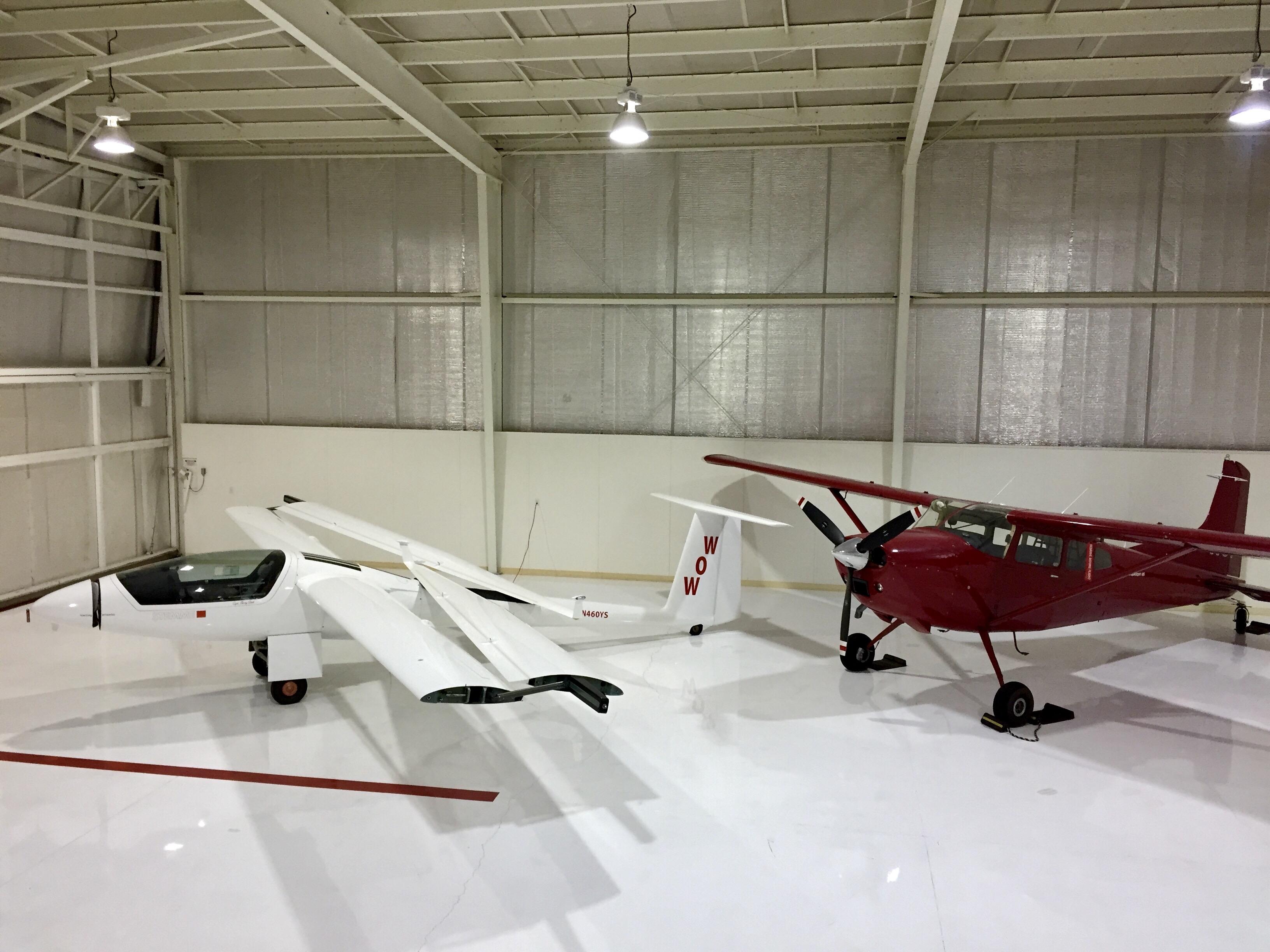

mikeschumann Posted August 20, 2020 Report Posted August 20, 2020 You should add the Phoenix Motorglider to your list. It is by far the best option available, even though it might be slightly above your budget. It's basically a 2nd generation Lambada, solving two of Lambada's biggest problems: 1. With the wing tips removed (takes 30 seconds; they weigh 15 lbs each), the Phoenix wingspan is 35', so it will fit in any standard T Hangar. The Lambada and Pipestrel motorgliders have 41' wingspans with the tips removed, so they won't easily fit in any standard US T-Hangar 2. The Lambada's cockpit is relatively short and the rudder pedals are not adjustable. If you are 5'11", after an hour or so, you will be very uncomfortable. The Phoenix has a longer cockpit and is very comfortable for 5+ hour flights. The only downside on the Phoenix is a 2+ year wait to get a new one delivered. There are about 25 flying in the US. Each year, one or two become available on the US market. Virtually all the Phoenix motorgliders in the US have Dynon Skyview glass cockpits with autopilots and ADS-B IN & Out. In addition they all have ballistic recovery chuts. They all have 100HP Rotax engines. Cruising speed is 110 knots burning 4 gallons / hour with a range of about 700nm. With full fuel you can carry 2 adults and 100lbs of baggage. Jim Lee, the US distributor, provides exceptional support. He is based in Minden and can give you lots of additional info. Before buying the Phoenix, I almost bought a Ximango. Two things totally turned me off. With full fuel you barely have enough gross weight to carry two adults without any baggage. The official baggage capacity is limited to 20lbs, even if you are only carrying partial fuel. The absolute deal breaker for me was the folding wing. It is VERY heavy and awkward, and scary to fold. On the way down, you are holding the wing just above the hinge, and have very little leverage. If you don't have the exact right technique, you will loose your grip and the wing will crash down causing major damage. Before you buy one, make sure you try out folding the wings so you know what you are getting into. Quote

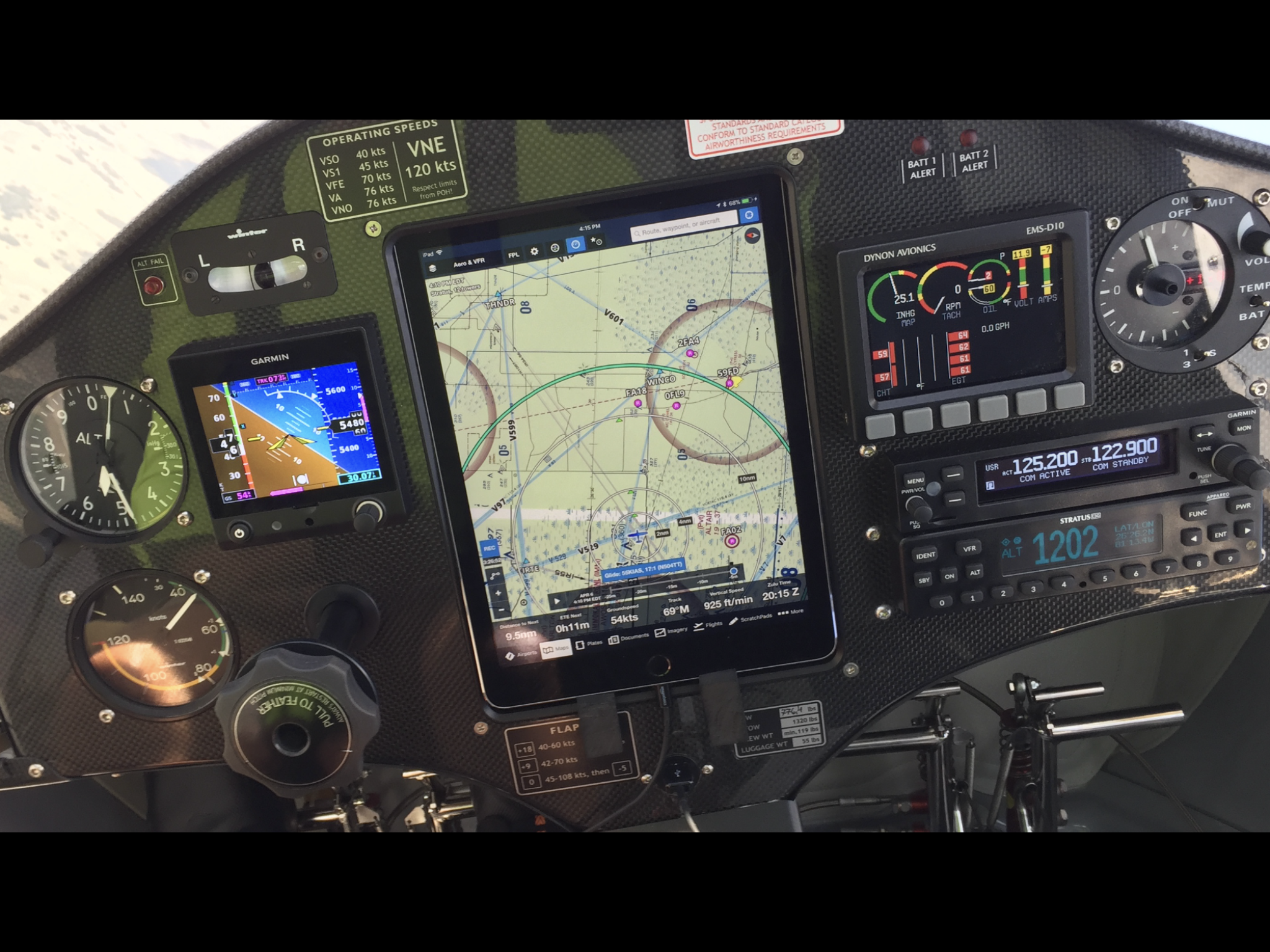

Todd Posted August 22, 2020 Report Posted August 22, 2020 Here are a few numbers that might be helpful with my 2017 Sinus Max. I never purchased the short tips and never found any reason to want them. With the tips off the span is just a bit over 39 feet. I am 6’ 2” and am comfortable with many flights over 5 hours. My Empty Weight is 784# with useful load 538#. I have the Ballistic Chute, 48ah of Batteries and ADS-B. With full fuel of 24.5g that leaves 391#. I think the most fuel I’ve had onboard was 22 gallons. With 23 gallons you can have 50# luggage and 350# for pilot and passenger. For local soaring flights I rarely have more than 10g fuel onboard. I’ve made 4 Round trips recently from KPMP to KSGJ of 462nm. The fuel burns were between 14.1 and 15.6g (average 14.9g) for a bit over 31 nmpg. These flights averaged 2.67gph and include weather deviations and gliding at the end of each flight. I use 100% Rec 90 fuel (Ethanol free unleaded) that I get from my local Shell station with current price $2.37/g. Quote
