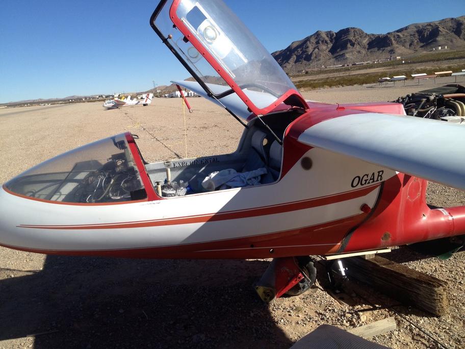

Sean Sweeney Posted January 28, 2013 Author Report Posted January 28, 2013 This is the before picture. Yes, the horizontal stab is not straight, the work of a local shop several years ago. It had been flying like this, but I expect it to be a little out of trim. The shop that did this told the owner it was to counter act torque... I will repair this as soon as I get home. It is a shame to have to go back and re-do a job that should have been done correctly in the first place! Also the gear collapsed at some point in the last year. I suspect the wind picked the poor Ogar up, and the gear was not properly locked down (it came down and all the load went into the idler/transfer arm). We had to remove the gear leg in order to get to the idler/transfer arm and have it re-welded. I was very lucky in that a local glider pilot volunteered to weld it up for me! Thanks James! It is now good as new (the gear). Quote
Sean Sweeney Posted January 28, 2013 Author Report Posted January 28, 2013 [ATTACH=CONFIG]104[/ATTACH]This is the before picture. Yes, the horizontal stab is not straight, the work of a local shop several years ago. It had been flying like this, but I expect it to be a little out of trim. The shop that did this told the owner it was to counter act torque... I will repair this as soon as I get home. It is a shame to have to go back and re-do a job that should have been done correctly in the first place! Also the gear collapsed at some point in the last year. I suspect the wind picked the poor Ogar up, and the gear was not properly locked down (it came down and all the load went into the idler/transfer arm). We had to remove the gear leg in order to get to the idler/transfer arm and have it re-welded. I was very lucky in that a local glider pilot volunteered to weld it up for me! Thanks James! It is now good as new (the gear). Quote
Sean Sweeney Posted February 7, 2013 Author Report Posted February 7, 2013 We had to remove the gear after first jacking up the fuselage. By researching on line and using google translator I was able to determine that "lift here" in Polish was written just aft of the gear (but no longer on this one). With the gear linkage repaired I cycled the gear a few times and then took it down off the jack. This Ogar has been converted to a hyd disc brake, and a 6:00x15-6 wheel and tire. This will make it much easier to find a replacement tire and tube, not to mention some real brakes as the stock ones will not hold it from rolling under full power. Quote
Sean Sweeney Posted February 7, 2013 Author Report Posted February 7, 2013 [ATTACH=CONFIG]105[/ATTACH]We had to remove the gear after first jacking up the fuselage. By researching on line and using google translator I was able to determine that "lift here" in Polish was written just aft of the gear (but no longer on this one). With the gear linkage repaired I cycled the gear a few times and then took it down off the jack. This Ogar has been converted to a hyd disc brake, and a 6:00x15-6 wheel and tire. This will make it much easier to find a replacement tire and tube, not to mention some real brakes as the stock ones will not hold it from rolling under full power. Quote

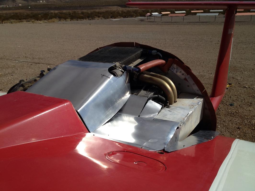

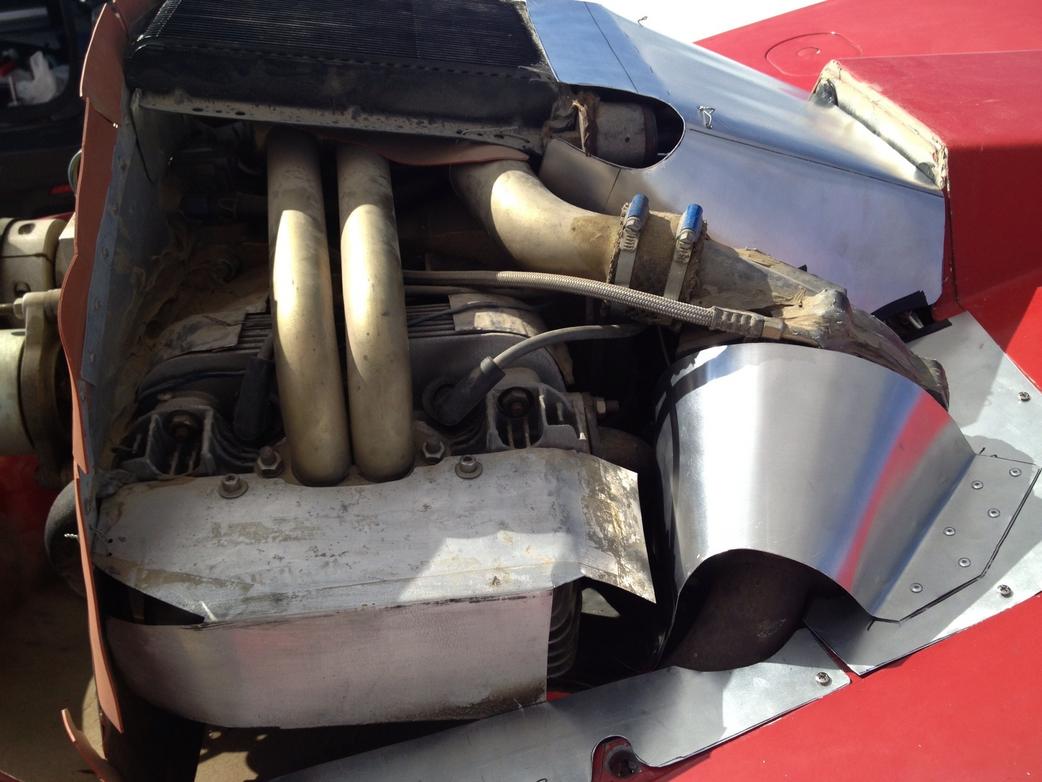

Sean Sweeney Posted February 7, 2013 Author Report Posted February 7, 2013 The Ogars sold in the US came with out the engine. They were test flown at the factory with a Limbach SL 1700, which was then removed before shipping. The recommended engine from the US importer, Aerosport, was a Revmaster 2100d Turbo made here in the US. This is the engine installed in mine. It has very little total time on it, and it was overhauled less than 50 hours ago. It puts out about 75 hp, and being turbo charged, should put out full rated power up into the teens. Some came with an optional Maloof metal adjustable prop, that later had some problems with the blades separating (not good!), however mine has a wood fixed prop. The cooling baffles were all missing, and it appears to have been flown that way. I decided to fabricate some temporary baffles for the ferry flight home. I still need to add some rubber seals. I will keep a close eye on the cyl head temps. My long term plan is to change it to updraft cooling as the pusher configuration lends itself well to that set up, and build a much lower profile cowl (to get every LD point I can!) Quote
Sean Sweeney Posted February 7, 2013 Author Report Posted February 7, 2013 [ATTACH=CONFIG]106[/ATTACH][ATTACH=CONFIG]107[/ATTACH]The Ogars sold in the US came with out the engine. They were test flown at the factory with a Limbach SL 1700, which was then removed before shipping. The recommended engine from the US importer, Aerosport, was a Revmaster 2100d Turbo made here in the US. This is the engine installed in mine. It has very little total time on it, and it was overhauled less than 50 hours ago. It puts out about 75 hp, and being turbo charged, should put out full rated power up into the teens. Some came with an optional Maloof metal adjustable prop, that later had some problems with the blades separating (not good!), however mine has a wood fixed prop. The cooling baffles were all missing, and it appears to have been flown that way. I decided to fabricate some temporary baffles for the ferry flight home. I still need to add some rubber seals. I will keep a close eye on the cyl head temps. My long term plan is to change it to updraft cooling as the pusher configuration lends itself well to that set up, and build a much lower profile cowl (to get every LD point I can!) Quote

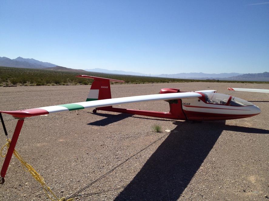

Sean Sweeney Posted May 20, 2013 Author Report Posted May 20, 2013 My brother and I flew down to Jean and worked on the Ogar all day Saturday. Before nightfall, we had it ready to fly. I set the alarm for 5:00am, as sunrise is at 5:30, so we could get an early start. After fueling up we discovered a fuel leak at the top of the tank, so it took an hour to sort that out so I could make a test flight to make sure everything was working. The winds were light, out of the south, and so I taxied out. Take off was uneventful, but I was only able to get about 3-400 from climb. The temps tho were manageable, and that was my main concern as there was no baffling installed on this motor when I got it. My crude baffling seemed to be working adequately enough to get the Ogar to my brothers shop tho. I landed and we refueled for the trip to Auburn. We had decided to take the long way by starting out heading south west to Barstow rather than direct to Auburn. This route left me with far more options should the need arise. We made it to Barstow averaging about 70 kits ground speed, and found we had an oil leak. We pulled the cowl, but could not pinpoint the source, and the oil level had barely dropped, so we cleaned it up, refueled, and headed for Lancaster. I had worked a few strong thermals on the way and was at 8,500' as we crossed the hight desert, so we decided to cross the mountains near Tahachape and go into Bakersfield. When I pulled up to the pump, Eric noticed large quantities of oil all over the tail boom, cowling, and tail. After removing the cowling we found the oil return line from the filter had broken off at the sump. How it had made it with out dumping all the oil out and seizing is amazing to me. The oil level was fine too, so I can only imagine that the line failed just before I shut down. Quote
