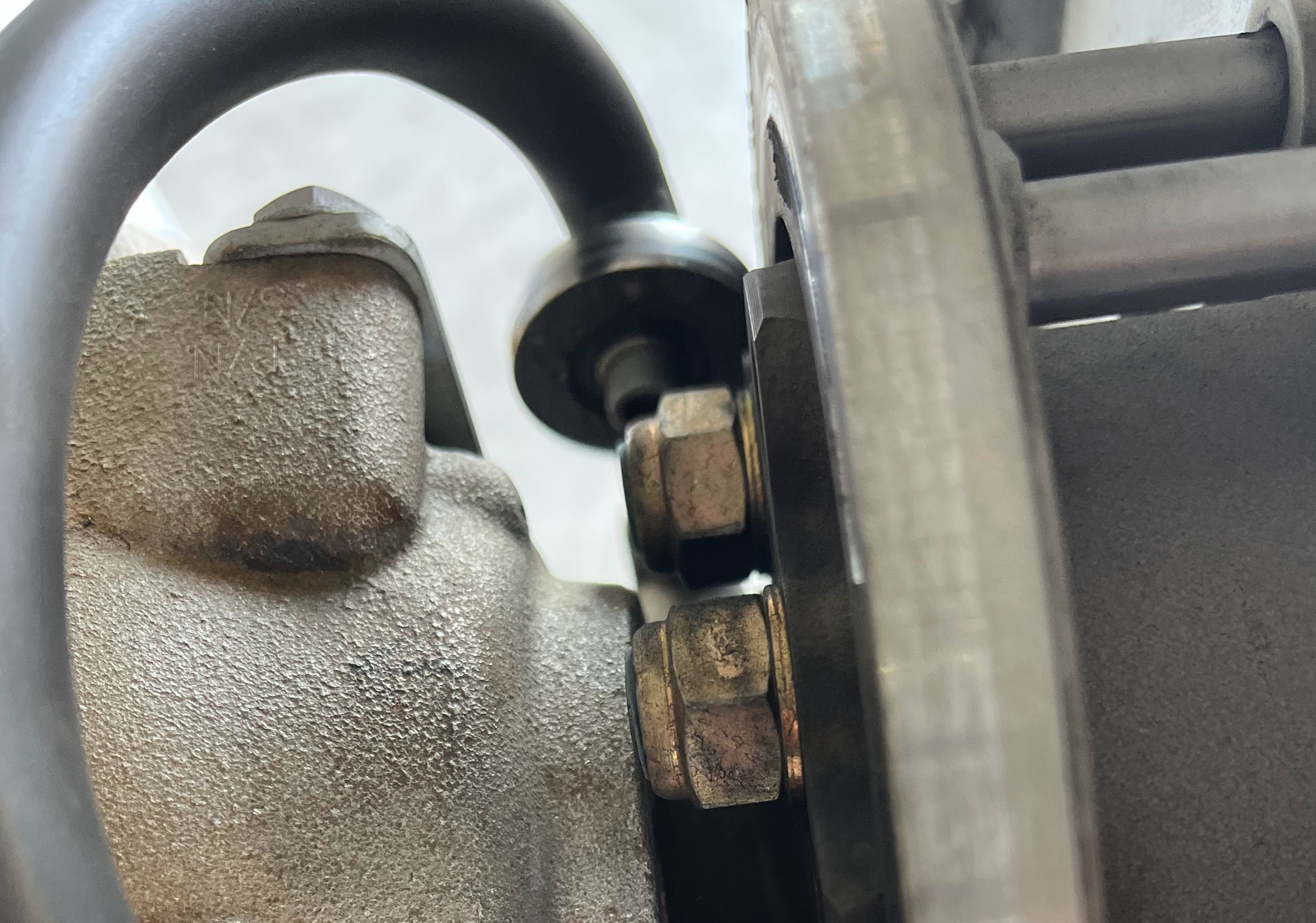

Does anyone know how to source replacement roller bearings that push on the Hoffman pressure plate for the AMT-200S?

Thank you for the help.  I didn't realize the Hoffman parts stop at the pressure plate (that's what they told me).  I just talked to Chuck at Ximango and it turns out there's a bearing press fit into an outer steel roller.  Note, there's supposed to be a visible gap between the roller and the pressure plate.
