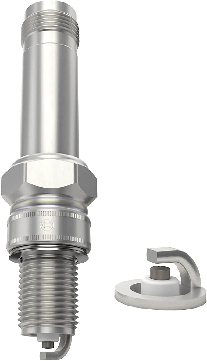

Interesting, when we pulled spark plug one and the bottom threads looked corroded.  It looked like this pic I stole from amazon.  My mechanic and I thought they were old looking.  My engine was rebuilt about 40 hours ago and they used the original plugs.   So it sounds like the corrosion was so bad when you pulled the plug it damanged the threads.  😞
