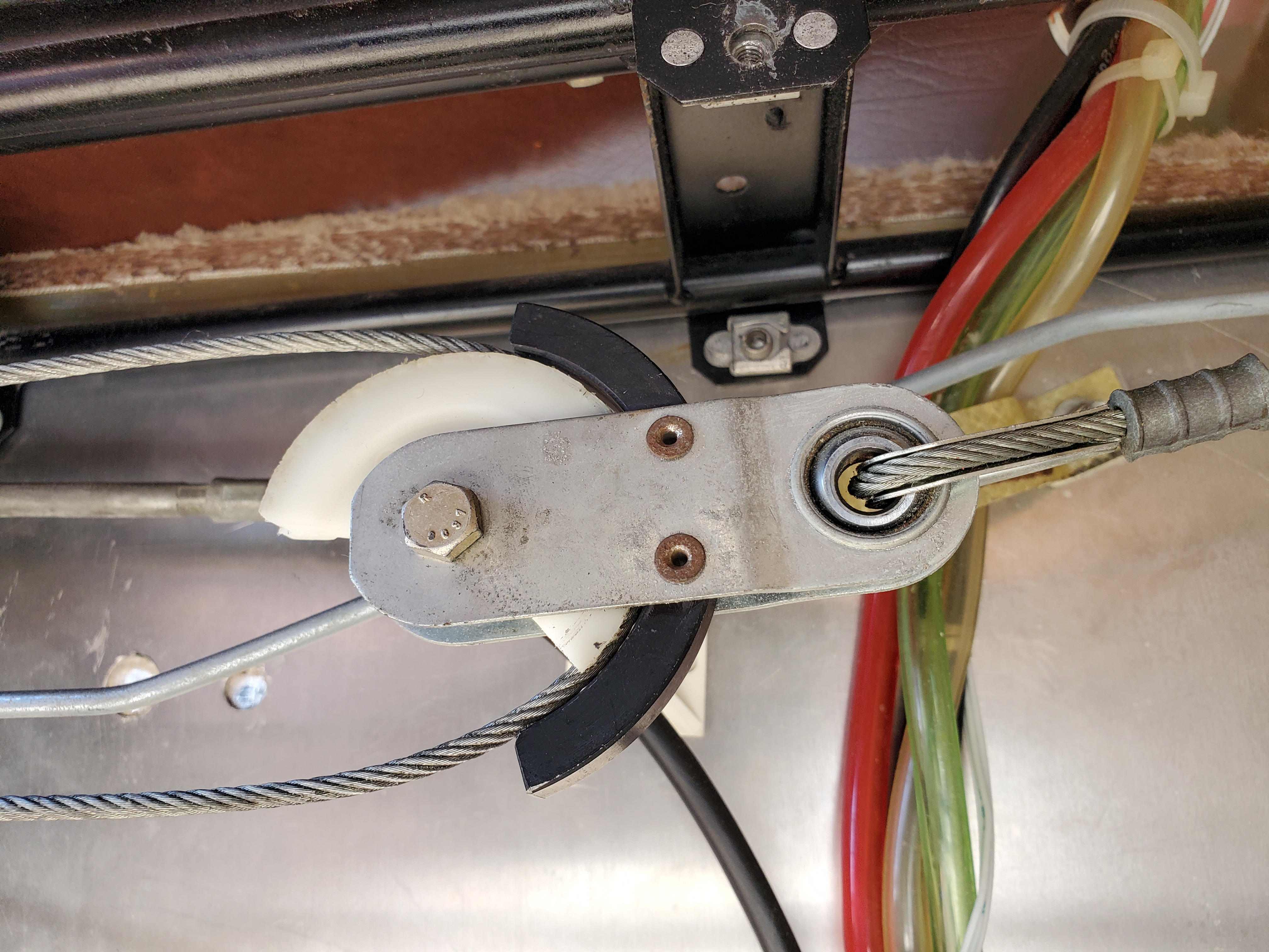

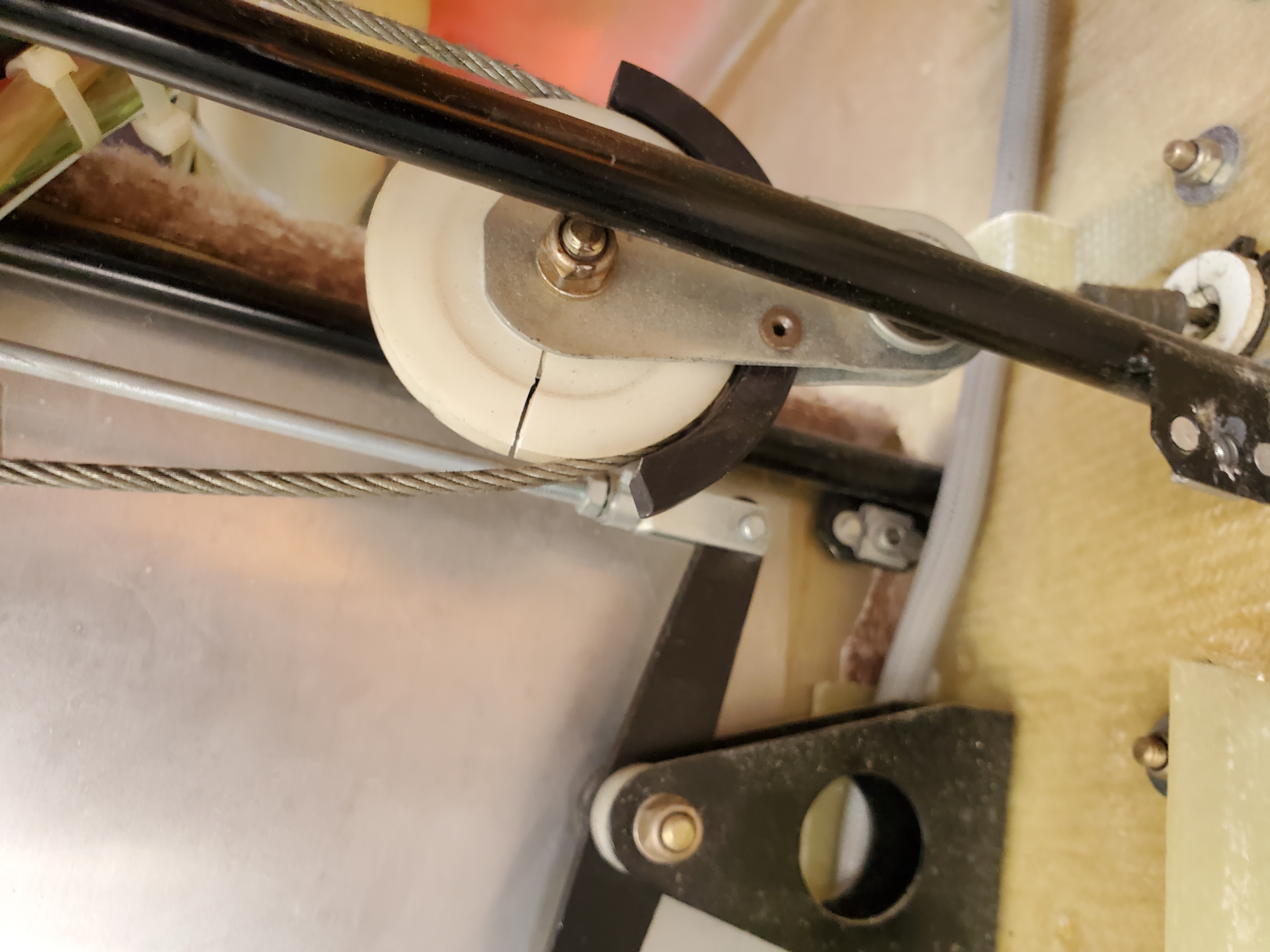

Pitch Control Pulleys, please inspect
I had pulled the right hand side panel for the center console.  I found the pitch control pulleys were past their serviceable life and need replacement.  They have cracks and my mechanic touched one and it fell apart.  If anybody knows where I can get parts, I would appreciate.
brian
Wicks, Aircraft Spruce and Wag Aero all sell control cable pulleys. If all else fails collect the pieces parts and machine one out of delrin.
