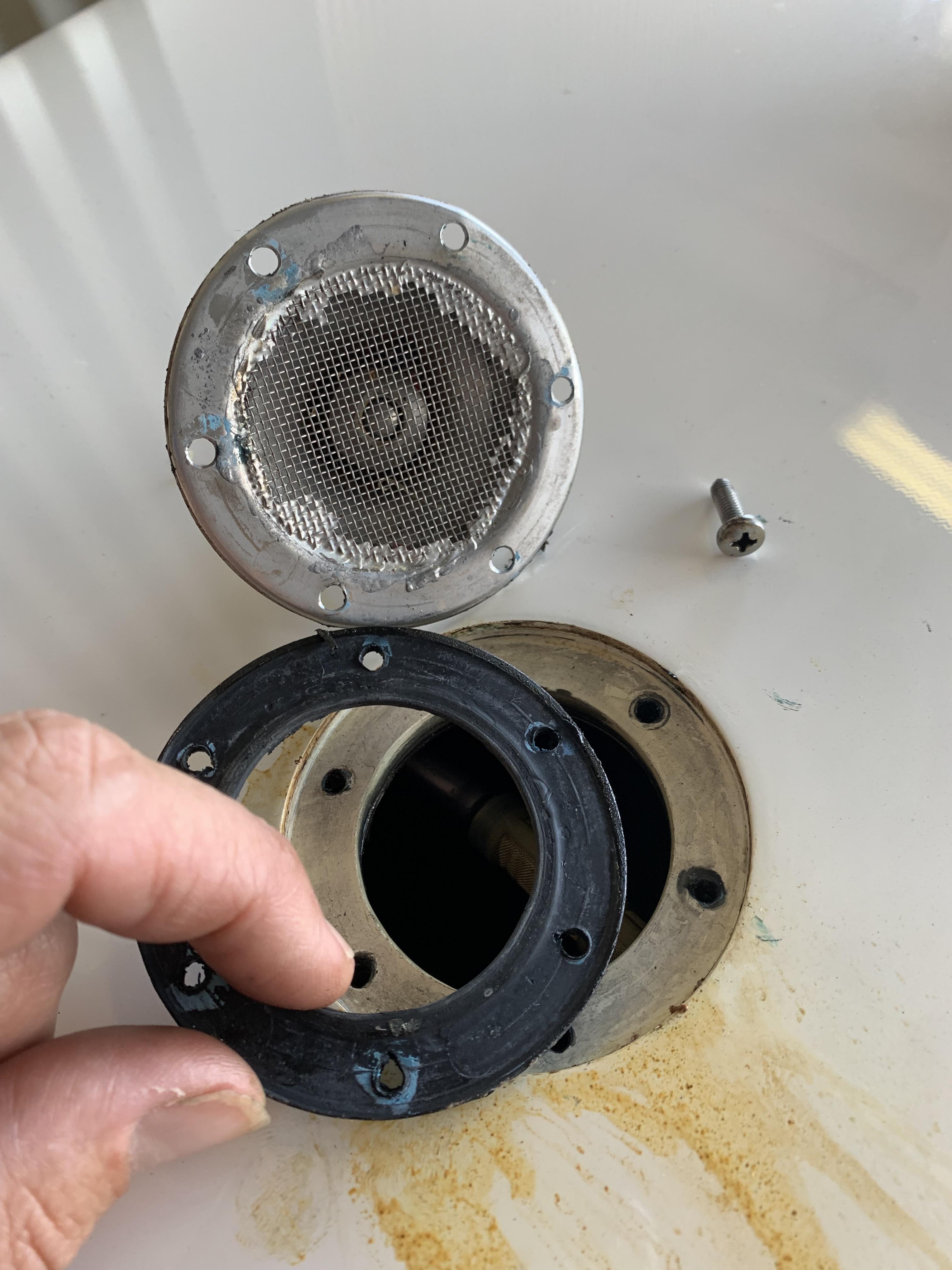

Alex Ress Posted April 7, 2023 Report Posted April 7, 2023 Rob R mentioned in a recent post that his fuel tank draining curtis seal was leaking and would be fixed at his condition inspection. I'm looking for suggestions on this one. An A&P has unsuccessfully fixed the seeping fuel from my fuel tank drain under the wing and more recently I was unsuccessful at the same task. Rob, if you might get a description of what your mechanic did and if it worked I would appreciate it. In my fix, I replaced the seal and used a fuel-appropriate sealant around the screws. Thanks to Rob R because now I know it's called a curtis seal. Anyone else have any war stories on this issue? Thanks, Alex Quote
Rob Posted April 11, 2023 Report Posted April 11, 2023 They replaced the rubber gasket. I will send them an e-mail and ask them about the partnumber and if the replaced the valve also. And every time I contacted Pure-flight I get an answer within a day. Grt Rob Quote

Rob Posted April 11, 2023 Report Posted April 11, 2023 Answer , only rubber gasket was replaced. Waiting for partnumber Quote
Rob Posted April 11, 2023 Report Posted April 11, 2023 Answer of compagnie was , they used the old gasket as a template to make a new one from a sheet of gasket material. So no partnumber yet. grt rob Quote
