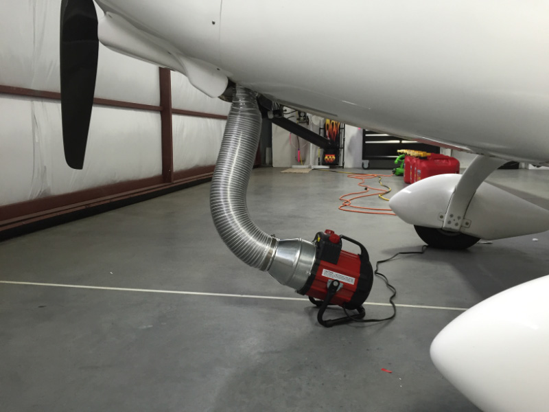

Registered No longer active on TMGA Posted March 11, 2016 Author Registered Report Posted March 11, 2016 I've copied the pre-heater Ed Walker made for his Phoenix. It's a small round unit from Sears that made it easy to connect a flexible duct to it. On Low heat, it's about 600W. The cold days moderated before I could test it, but it raises the under cowl temperatures quickly. The oil temperature indication goes up about 15 deg/hour, but I don't know where that's being measured. Quote
pik20e4me Posted March 15, 2016 Report Posted March 15, 2016 Looks nice. One of the things I did for my Ximango to help with cold weather starts was have the avionics shop install an external plug for auxiliary power. The 912 is not easy to start the first time in a day, but if you get it started once it tends to work better. So I bought an aux power unit that puts in quite a few amps (don't have the number handy). My back-up plan was to chain together some older 12 volt batteries into a wagon and keep it charged so I could have my own aux power unit with really high amp potential. Quote

Thermalseeker Posted May 31, 2016 Report Posted May 31, 2016 On 3/10/2016 at 10:39 PM, Eric Greenwell said: "The oil temperature indication goes up about 15 deg/hour, but I don't know where that's being measured." On most Rotax 9xx series installs I've seen the oil temp probe is installed on the oil pump. Ditto the oil pressure probe, although some locate the actual oil pressure probe itself elsewhere, like on the firewall via a length Aeroquip or similar pressure rated hose. My Ximango has a Volkslogger data logger tied into an Ilec SN10 Flight Computer. The oil pressure probe is remotely located on the firewall, but the hose ties in at the oil pump on the front of the engine. The Volkslogger also has an oil pressure switch which tells the Volkslogger if the engine is running or not. This switch is plumbed in right next to the oil pressure probe. Quote
