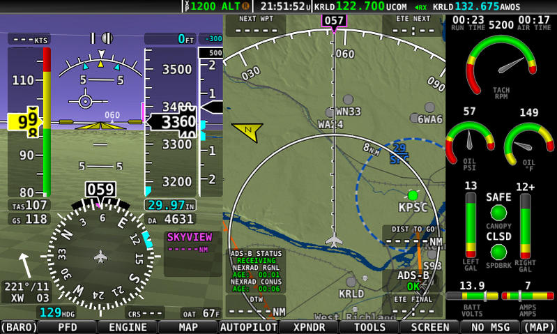

The best part of SV 11 is you can now set Vne as a TAS (true airspeed) number. That's exactly what the Phoenix needs, as it's Vne is 120 knots TAS! The picture shows my screen in flight after installing SV 11 and setting the Vne to 120 kts TAS.
Note how the "red line" starts at 112 knots IAS, due to the higher density altitude of 4631 feet. This is a dramatic improvement for us, and should help avoid over-speeding Vne, especially at the higher altitudes out West.
