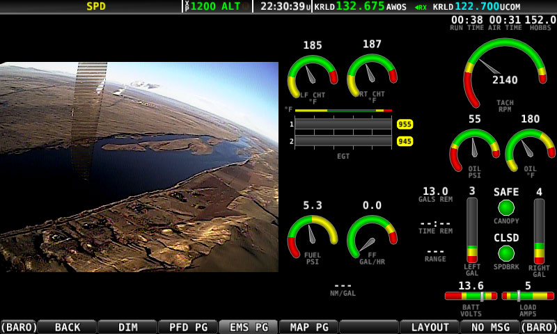

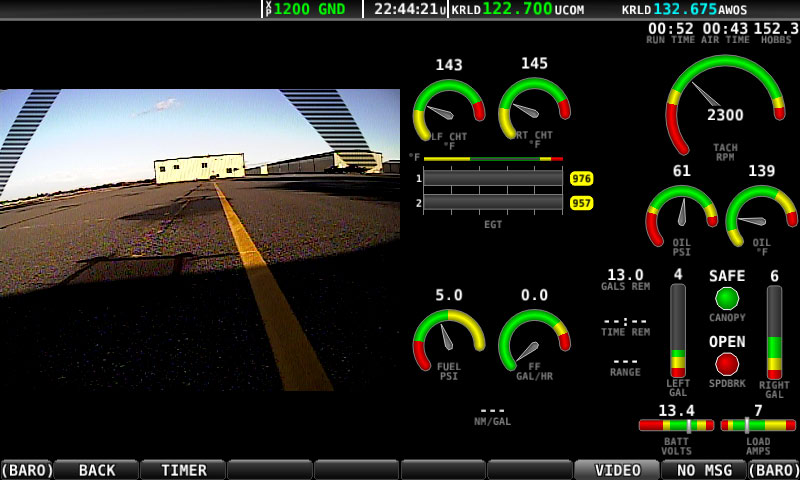

Registered No longer active on TMGA Posted December 23, 2014 Registered Report Posted December 23, 2014 (edited) I've temporarily mounted a small "bullet" camera under the Phoenix, just ahead of the landing gear. It displays the image on the Dynon SkyView monitor, using the Dynon video adapter. It's nice to see ahead of the plane while taxiing, and I think it will be a help for maneuvering into thermals, because I'll be able to see where the dust devil is below me. The image is shown 50%, with the other 50% being the engine page (shown), or the PFD or Map page; it can also be shown 100%, so it almost fills the screen. Edited December 23, 2014 by Eric Greenwell Quote

Registered No longer active on TMGA Posted December 23, 2014 Author Registered Report Posted December 23, 2014 Eric, would you tel us the name of the bullet camera you used, please?It's the "BOSCH SECURITY VIDEO VTC-206F03-4 Indoor/Outdoor Mini Camera" that I bought on Amazon for $72. I tried a few car "backup cameras", which are attractive because they are $15-$30, also waterproof, smaller and lighter, but all had at least one issue: poor image quality, too wide a view, color washed out in sunlight, reversed image (standard for backup cameras - a couple units had a setting to change that), or guide lines on the image. The Bosch unit avoids all those issues, but it is a bit harder to mount. Quote

mikeschumann Posted May 4, 2017 Report Posted May 4, 2017 Any updates on your Taxi Cam? Today, I had a major screw up and hit a plastic runway marker cone while taxiing. It ended up destroying my prop, which is another expensive lesson. A Taxi CAM (or more aggressive S curves) would have saved my bacon. Quote
