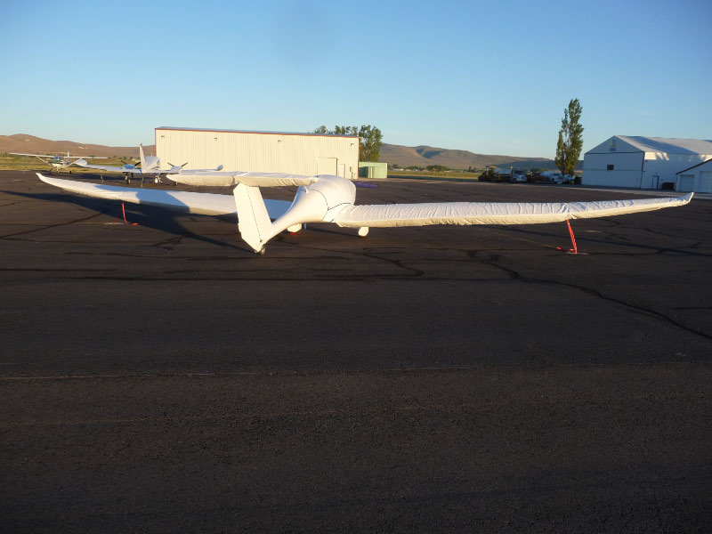

John's approach (block sanding) is more effort than I can muster, so I'll do what I've done for all my sailplanes: keep it covered, wax at least once year, and avoid temperatures below 0 deg F.
"Covered" is achieved with a hangar (which has additional advantages, of course!) when it's home, and with wing and tail covers while it's traveling. My wife and I made the covers from the Tyvek used for RV covers: the wing/tail set is light (5 lbs) and compact; it's easy to use them; and the materials cost $150. Russ Owens made a similar set for his Phoenix.

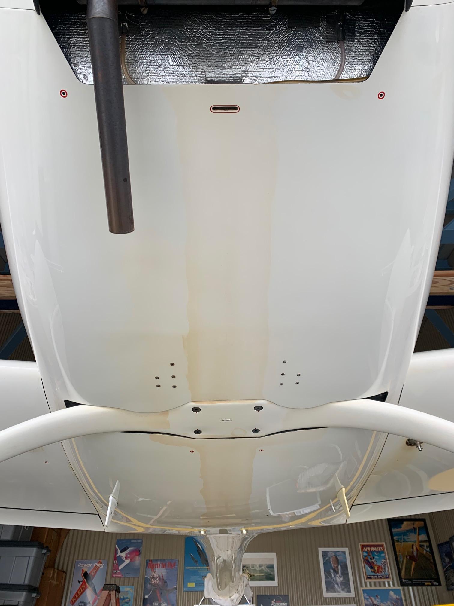

The good news... I started using an aircraft lift for additional room in the hangar.  The bad news is that the lift puts the dirty phoenix belly in my view plane.  The attached picture is after cleaning with soap, then clay bar, then polish on a buffer and lastly Maguire's Cleaner Wax on a buffer.   The yellow discoloration seems to be where the glass is overlapped and bonded.  If you can't see the picture there is a 6" center band of discoloration running the length of the fuselage.  Tapping around the discolored area indicates a thicker material.  This is a 2018 model (#44).   Anyone have any data on why the areas with overlapping or bonded glass would have a greater tendency to discolor?  Would this discoloration still have occurred if I did a better job of cleaning the belly?
