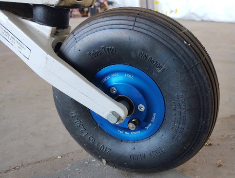

HiFlite Posted November 18, 2021 Report Posted November 18, 2021 The 1-piece tail wheel makes it very difficult to change the tire and tube. This TSO'd 2-piece TOST wheel is a near-perfect fit (the spacer lengths need to be slightly modified to fit your fork.) https://wingsandwheels.com/aircraft-parts/wheels/3-inch-tost-tail-wheel.html The TOST tire is reported to be of much better quality than the AeroClassic, which tends to be not particularly round. Quote
