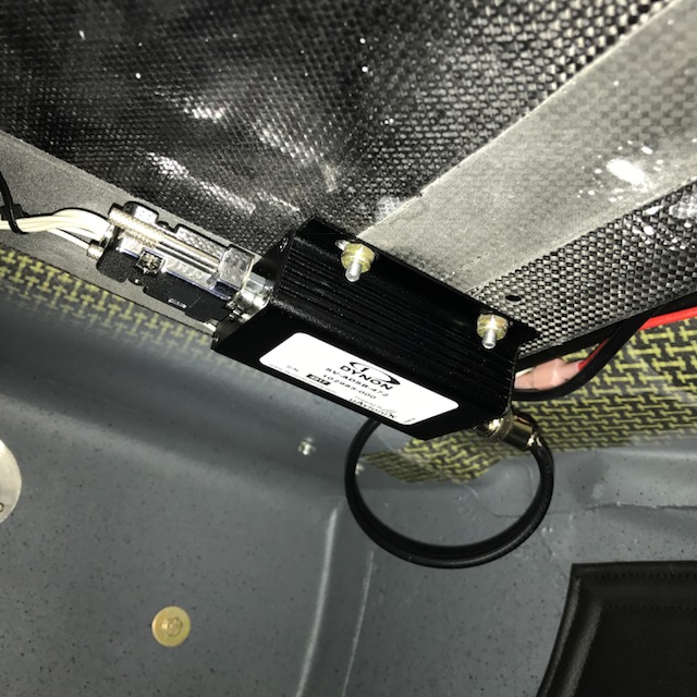

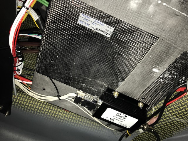

This morning I swapped out my ADSB-470 for the new dual channel ADSB-472. If your ADSB-470 is installed according to the Phoenixair LOA, it's actually quite easy to do. So, for those of you who are contemplating this, let me describe the process.
You simply unplug the old unit's DB-9 serial cable and antenna and take out the mounting bolts. The trick is to find an offset Phillips screwdriver for the inside of the glove box. Keep the bolts and locknuts for reuse. Reconnect the new unit (serial interface DB9 and antenna). It's a different physical form plan with the connector on opposite ends instead of the same side, but the whole unit is only about half the size of the ADSB-470, so there's plenty of slack. Attach the unit using the right forward bolt hole with a single bolt, and then drill the 3 new holes through the guides on the unit. Replace the other 3 bolts and locknuts. Next enter SETUP and change the device in the Serial Port setup to ADSB-472 and it fires up on reboot. You can see the position of the new unit relative to the old bolt holes in the pictures.

Thanks for the info and pics.  This old post made it much easier for me to upgrade to ADSB-472 and GPS-2020 today. It took a few hours of planning and contortions, but it would have been a lot longer without learning from your post.
