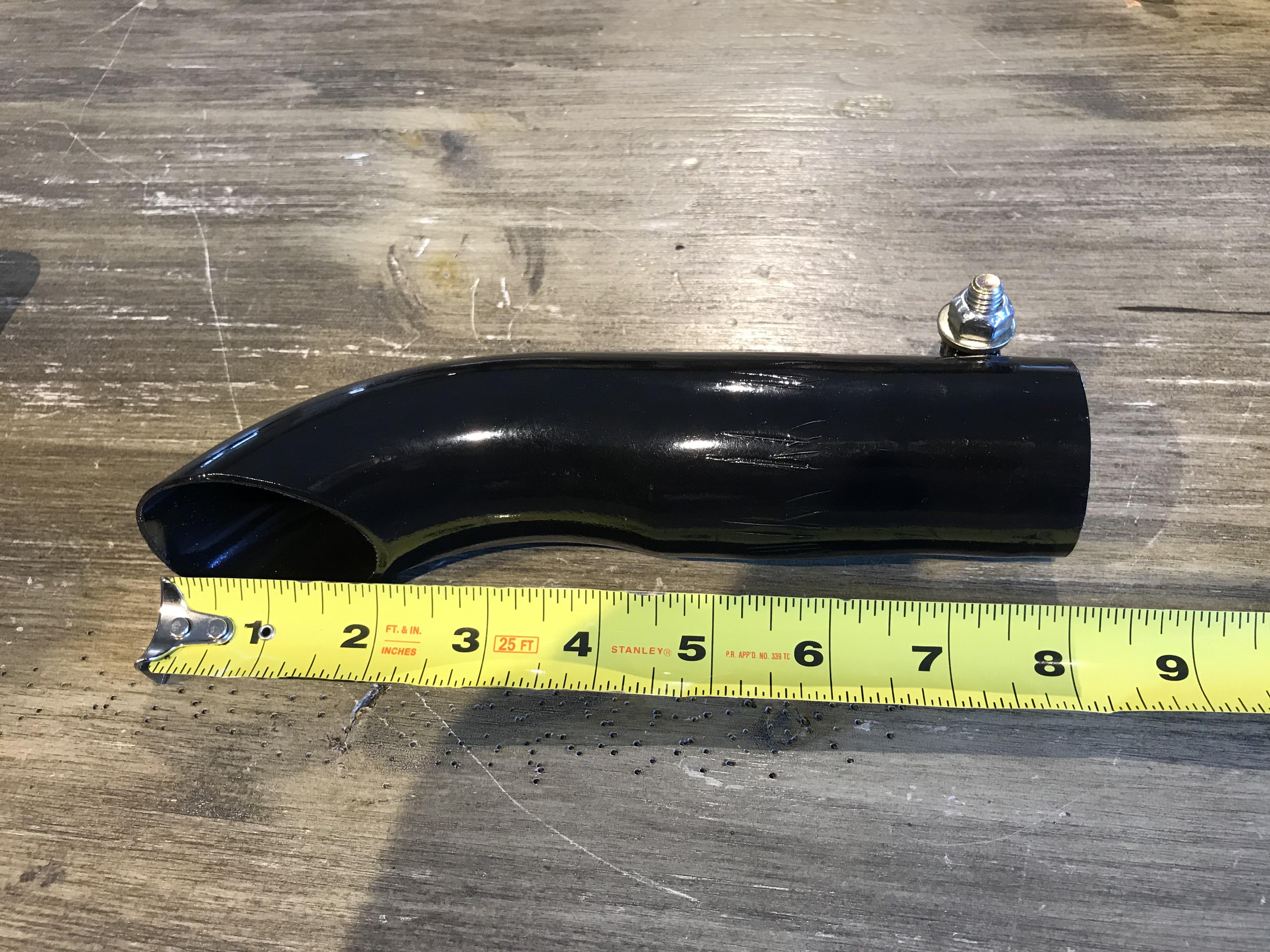

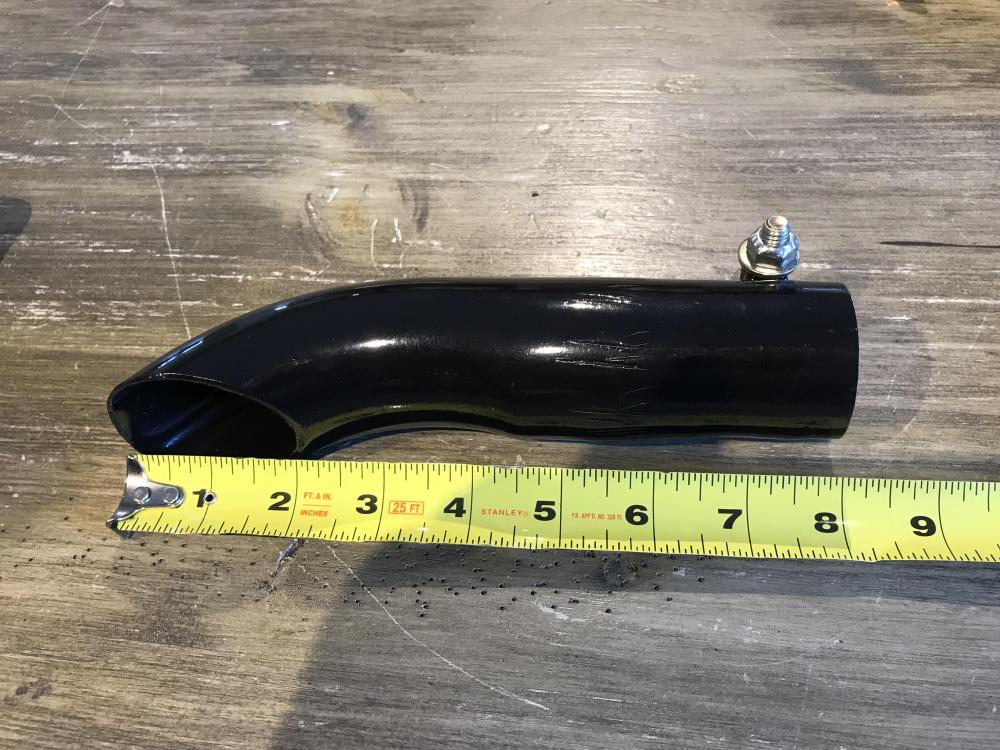

Registered No longer active on TMGA Posted December 21, 2017 Registered Report Posted December 21, 2017 I get tired of cleaning the bottom of my Phoenix, so I'd like to find a way to divert the exhaust stream downwards; for example, something like the "turn down exhaust tip" in the picture (it's about 9" long, and comes in several diameters). Any idea if this would reduce the oil goop on the fuselage, and not adversely affect engine operation? Quote

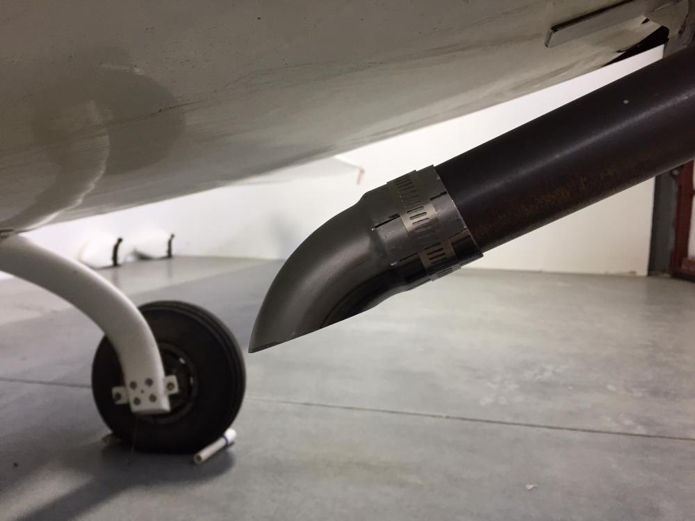

Registered No longer active on TMGA Posted January 10, 2018 Author Registered Report Posted January 10, 2018 I couldn't find an exhaust tip to divert the exhaust flow downward, so fabricated one from a 180 degree bend tubing piece (1.5" OD tubing, 3" radius bend). The Phoenix exhaust tubing appears to be metric, about 40mm OD, so I had find an exhaust shop that could expand the end of the tubing enough to slip over the Phoenix exhaust. The end has 8 slits cut in it, and a hose clamp holds it to the Phoenix pipe. I hope to fly with it tomorrow. Quote

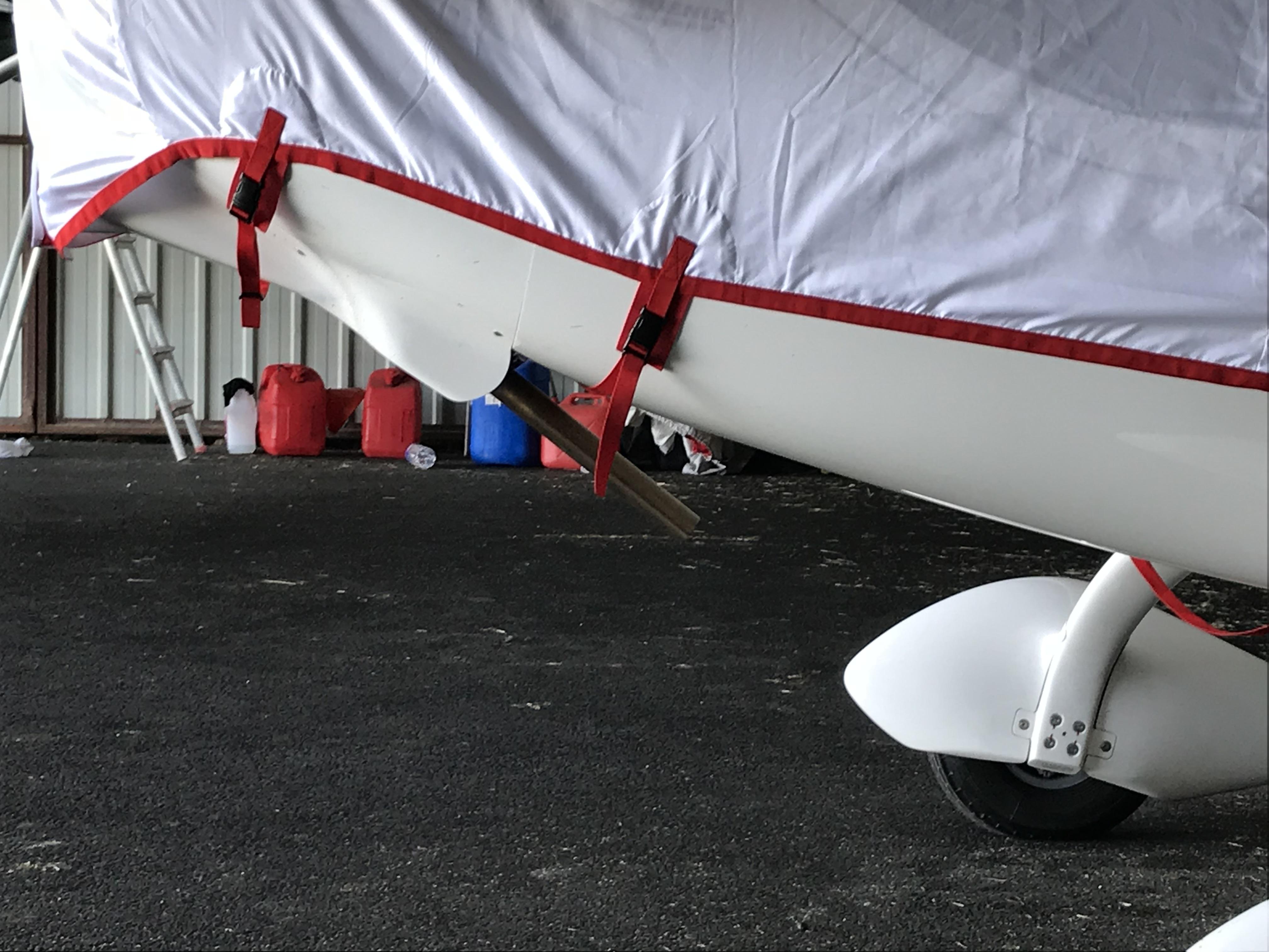

Rob Posted January 10, 2018 Report Posted January 10, 2018 I like your chocks . They look they are made out of plastic Quote
Registered No longer active on TMGA Posted January 10, 2018 Author Registered Report Posted January 10, 2018 I first saw that sytle of chocks at Ed Walker's hangar. It's made out of 1/2" PVC pipe and two right angle fittings that are glued together - standard Home Depot stuff. They are effective, cheap, and easy to make. I carry one in the glider for tying down when away from the hangar. I can get a picture and dimensions later if you like, but it's easy enough to cut the pieces, fit them together, then glue once the lengths are right. Quote

mikeschumann Posted June 26, 2018 Report Posted June 26, 2018 I had my local muffler shop manufacture the attached diverter, which I hope to install tomorrow. Total cost was $50. He'll make more if anyone else is interested. A question to Eric: When you installed your diverter, did you aim it straight down, or at an angle to the side? Quote
Registered No longer active on TMGA Posted June 30, 2018 Author Registered Report Posted June 30, 2018 I mounted it with exit facing directly down. When I've flown enough t have a deposit on the fuselage, I'll consider changing the orientation, but so far, the fuselage stays clean. Your diverter appears to be twice the length of mine (and likely double the weight). Mine loosened after a while, so I suggest you check your diverter's attachment carefully before every flight. Quote

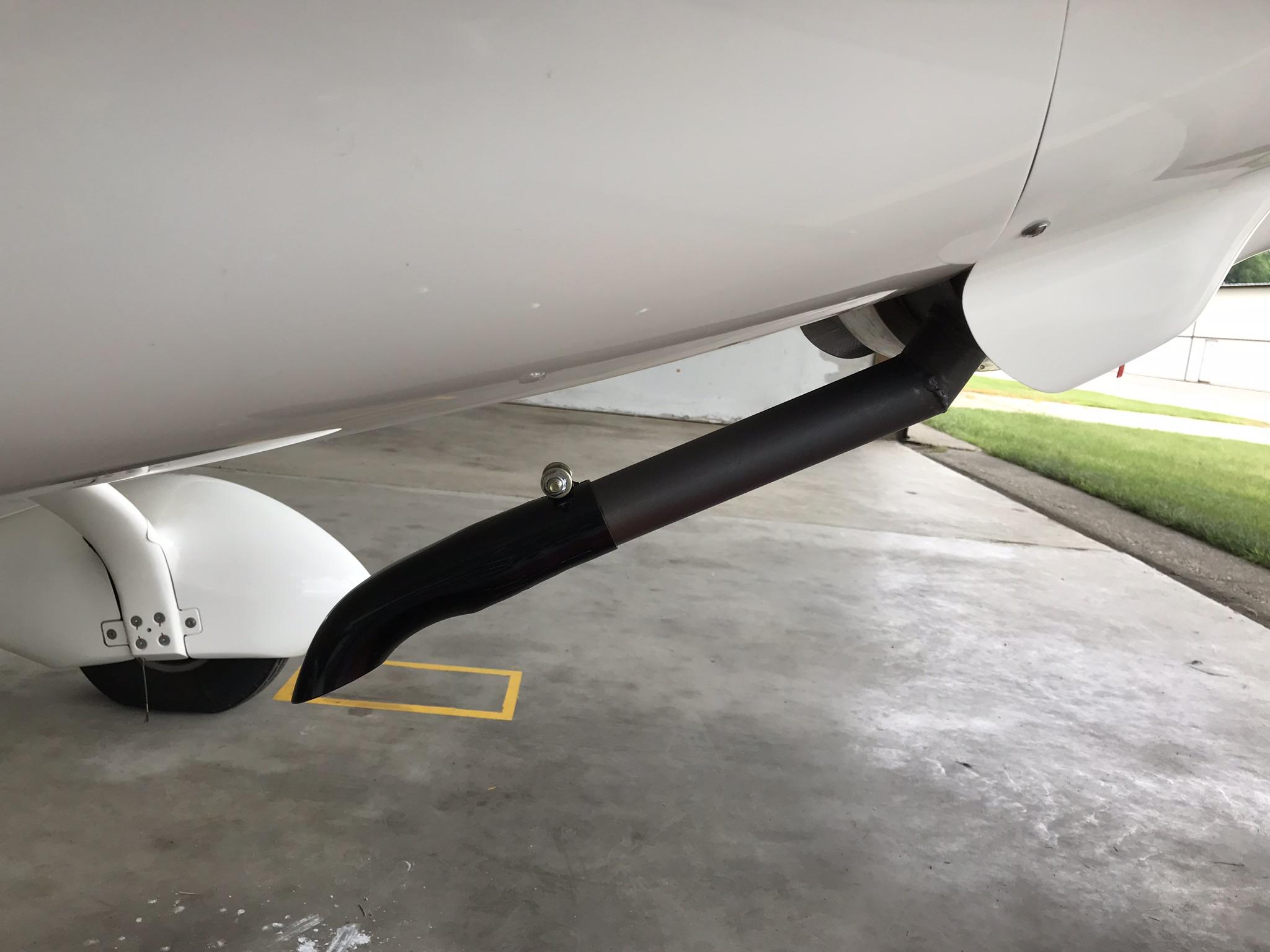

mikeschumann Posted June 30, 2018 Report Posted June 30, 2018 Attached is a picture of my installed diverter. The existing exhaust pipe is inserted almost half of the way into the diverter. If I was going to have another one built, I would try to have it made shorter, like yours. However, the total weight of my diverter is only 0.8 lbs, so I am skeptical that it would be worth redoing. I was a little concerned about using a hose clamp to attach the diverter, so I had the muffler shop weld on two brackets on either side of a single slot cut into the diverter colllar. I am using a bolt with a lock nut to tighten the collar over the exhaust pipe. It is a very solid connection. It will be interesting to see if it loosens up over time. Thanks for the inspiration to do this. Quote
