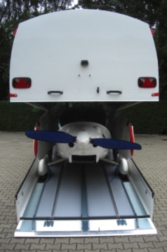

edwalker Posted February 7, 2018 Report Posted February 7, 2018 I just saw this photo of a Cobra Trailer designed for the Lambada. Since the Phoenix is not that dissimilar in size, does anyone know if a Cobra trailer has every been built for the Phoenix? I just sent the Cobra factory a note asking if it can be done and for what price. I've looked locally over several states to find someone who will build one similar to the custom trailer that Don Boardman had built in upstate NY, but there aren't many options near Seattle. Also, they tend to be quite heavy, and I don't have a pickup to haul it around. I have a Subaru Outback that can tow 3000 lbs, so I'm hoping that Cobra's experience with the Lambada will allow them to make something not too heavy. I'll let you know. Quote

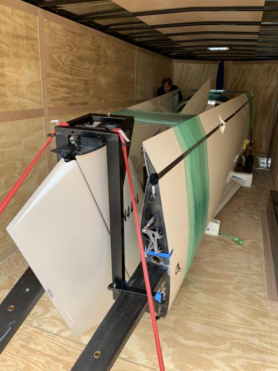

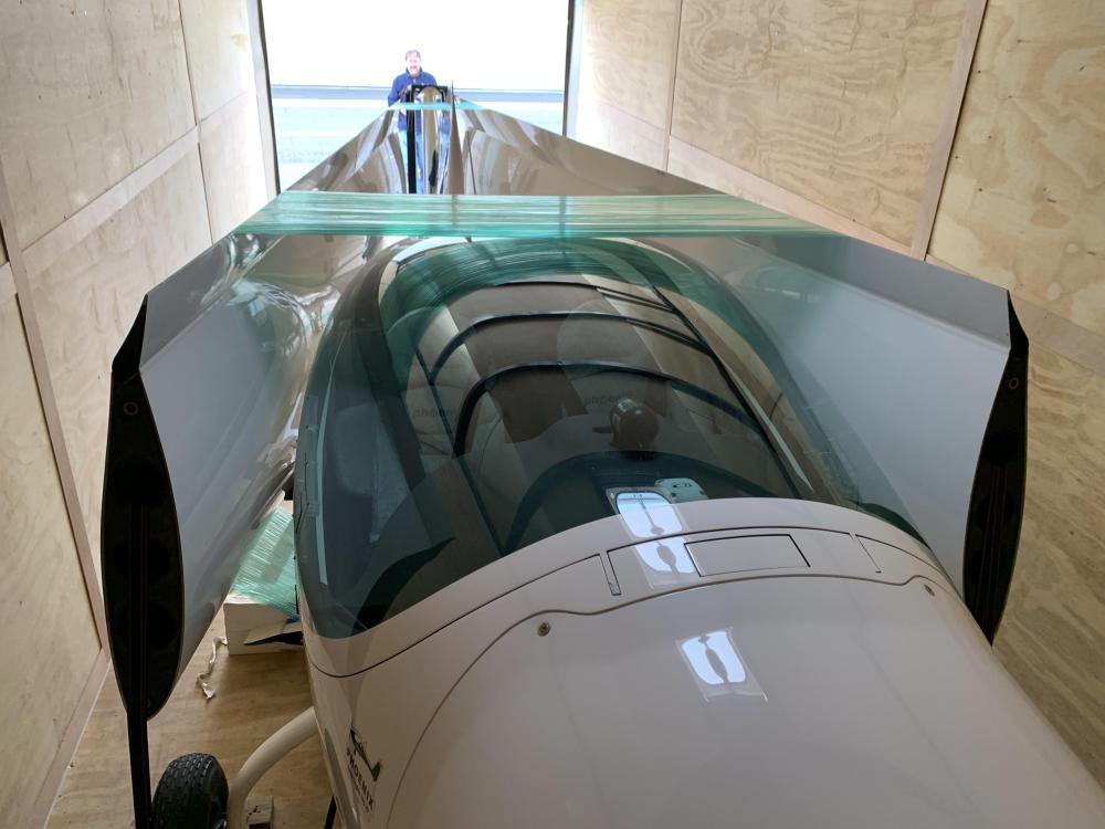

Alex Ress Posted April 12, 2022 Report Posted April 12, 2022 This doesn't help Ed with trying to keep the tow below 3000lbs but I used a generic 24' double axle trailer to ship #44 to Honolulu. Yes Mike, I could have flown part way. Afterwards, I used the trailer for several months, packing and unpacking to fly, until I got a hanger. Nice thing about buying a large generic trailer is the high resale value it will have if/when you decide to sell it. I rented a reasonably priced U-haul to tow it from Minden to Oakland. The black steel cradles holding the wings came from Czech Republic, are specifically designed for the Phoenix and were purchased from the newly retired Jim Lee (congratulations!). There are side stories on all phases of this adventure that I'd love to share if anyone is considering this route. Quote
