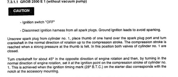

Hello,
I found a little timing mark from the propeller plate but where I should align it?
The notch on the propeller hub should line up with the split line of the crankcase.
