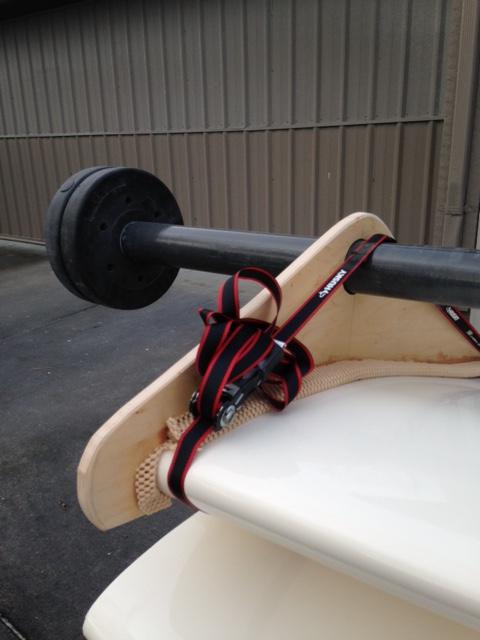

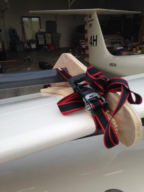

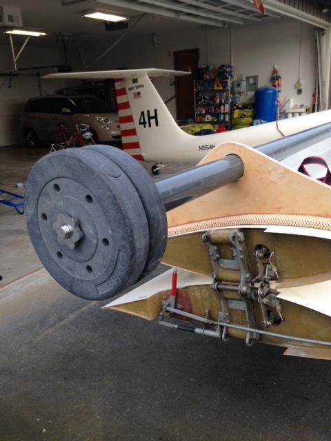

Yes, there is hope for us wimps. I am 5'7", 230 lbs. and 73 years old and yes I have problems opening and closing the wings so I built a simple lever system and it is very doable now. It consists of a 10' carbon tube (what I had from an old delta hang glider) two wing shaped plywood pieces, a couple ratchet straps and two 25 lb. bar bell weights. The system reduces the lift weight from 30 lbs at the wing tip to about half that. My concern was what if it should slip while in the vertical position? I glued a rubberized material to the surface next to the wing for protection of the wing but when the ratchet straps are tightened nothing moves. The second issue was how far out could I go and not hit the ground when in the vertical position? Further than I thought but a quick measurement on the first lift answered the question and I have sense put stops on the tube so when I mount it no further measurement are required.

Quite clever, Steve! This scheme would also reduce the risk of damage from a "slam down" in the event one lost control, say, in windy conditions.
Pure genius, Steve! I flew hang gliders for 28 years. I thought that tube looked like a carbon crossbar. from a topless glider. LOL! I've got an old topless in my barn. I may have to rob one of the cross bars and make one of these. Thanks for sharing!

Steve's design is awesome and a life saver!!   Thanks for everything !!  P.S.  She is still flying weekly....
