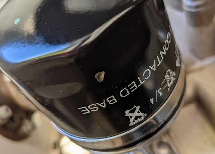

I went for a fly last weekend for some local soaring in pretty average conditions so I kept the engine idling (and used it a few times) on a 2.1 hr flight. When I landed and parked I noticed a puddle under the engine and realised I had oil all under the fuselage.
The engine still burped (gurgled) when i turned the prop but there was no oil visible on the dip stick.
This was only my 4th day flying since the annual inspection and oil change.
Some investigation found a small triangular hole on the underside of the oil filter.

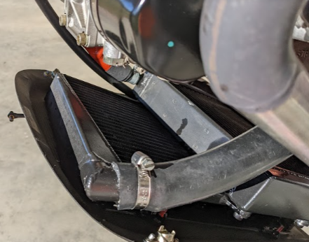

Some further investigation concluded it was caused by the nut on the hose clamp on the radiator. With the cowls off the radiator hangs down
but I assume when all mounted the radiator is raised up and puts the hose clamp within striking distance of the oil filter.
Some rough, one-hand video here: https://photos.app.goo.gl/1qEBsKLyQCorRkih8
I have not put it all back together yet - so I don't know how close it is in normal position, but we will obviously be moving the hose clamp screw!
I think I was very lucky ... it must have failed just as I was taxing back, (After a very smooth landing I might add  - first real X-wind for me!)  based on the size of the puddle both where I parked and where I had to wait a few minutes to get back to my hangar. I didn't lose oil pressure so I assume no further harm done.
Has this been seen before?

I had the same thing happen to me after a "rubber change", where I noticed drips on the hangar floor after about 10 hours from the rubber change, drips which got worse with more flight time. Eventually, I found the leak in the filter. With the cowling off, the radiator hangs down, giving the appearance of plenty clearance for the hose clamp in the "up" position. The proper location is 180 degrees from your position. The amount of clearance varies from plane to plane, so some with the hose clamp "up" don't touch the filter, and all is well.
Some/lots of oil got into the oil radiator fins. I tried to clean it out with solvent and some air pressure, but it still took many hours of engine time before the drips on the floor ended.

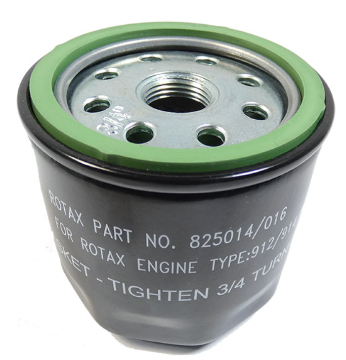

What kind of oil filter is that?  Not that has anything to do with the puncture.

As far as I know it is the standard Rotax filter.

I've been getting Rotax oil filters from California Power Systems / Aircraft Spruce.
