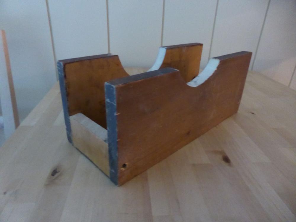

In replacing a tire, I did not have the tools to pry the tire off the rim as suggested in the maintenance manual. How have others changed tires?
 In the interim, I found it easier to disassemble the rim into two halves by removing the six screws.  I have now built a wheel stand to simplify the process of removing the six screws. By placing the deflated tire in the stand, the wheel is steadied so that I can use an allen wrench in one hand and the nut-driver in the other. For the stand, I used some 1 x 6" wood from another project.  Two 13" boards are separated by 2" x 4" blocks. The scooped out area probably isn't necessary, but I wanted to be able to reach all the screws without moving the tire (depth of 1 1/2" through the middle third of the board). Just make sure to keep the cone shaped axle spacer in place while reassembling the two halves (I use a section of dowel almost as thick as the narrow end of the cone).

Interesting jig....
