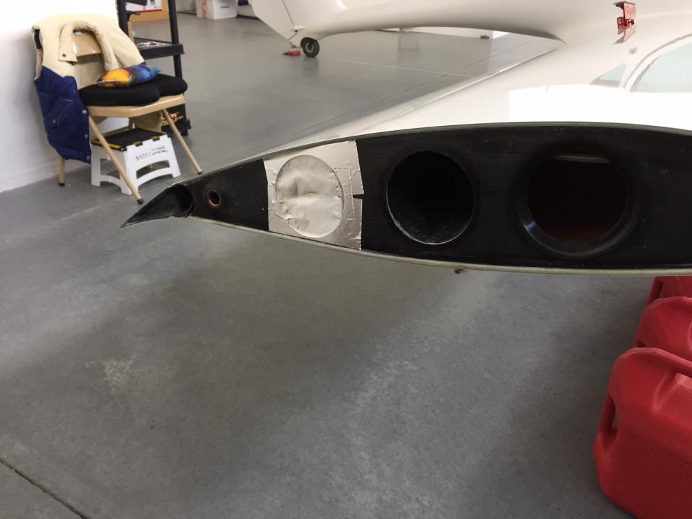

The steady stream of cold air coming into the cockpit from the flap and spoiler slots between the seats is quite annoying. A small towel can be placed over it, but that's annoying also. I think the air is coming from the wing root, and likely gets to the wing root from openings in the wing, such as the joint between wing and wing tip, and perhaps from the wing/flap gap on the underside of the wing. Sealing the fuselage root might stop all/most of the air from entering the cockpit, but it's a lot of trouble to pull the wings out and seal the pushrod openings (or even trying to do it from the inside baggage area), so instead I blocked what I hope is the major entry point:
I temporarily taped over the rear opening in the outer end of each of the inner panels, as an inspection of the forward hole and the center (tip spar) hole found they appeared to be fully sealed. During the next flight in wave at 28 degF OAT, the cold air coming in seemed very reduced, so on to the next problem.

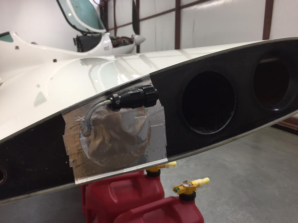

The attached picture shows how I revised the sealing of the inner wing at the tip parting line, making the strobe/navigation light connector easily accessible. The wing tip lighting cord is quite long, so I wrap it once around the spar while the wing tip is hanging after placing the spar in the wing spar opening. On the last flight, I was comfortable down to 20 deg F OAT, dressed in blue jeans, sweatshirt, and a light vest. Late in the day, under cloud shadows, I did start to feel a little cool. The idling engine supplies a totally inadequate amount of heat to the cabin, so I'll be dressing warmer when the temps drop below 20 deg F.
