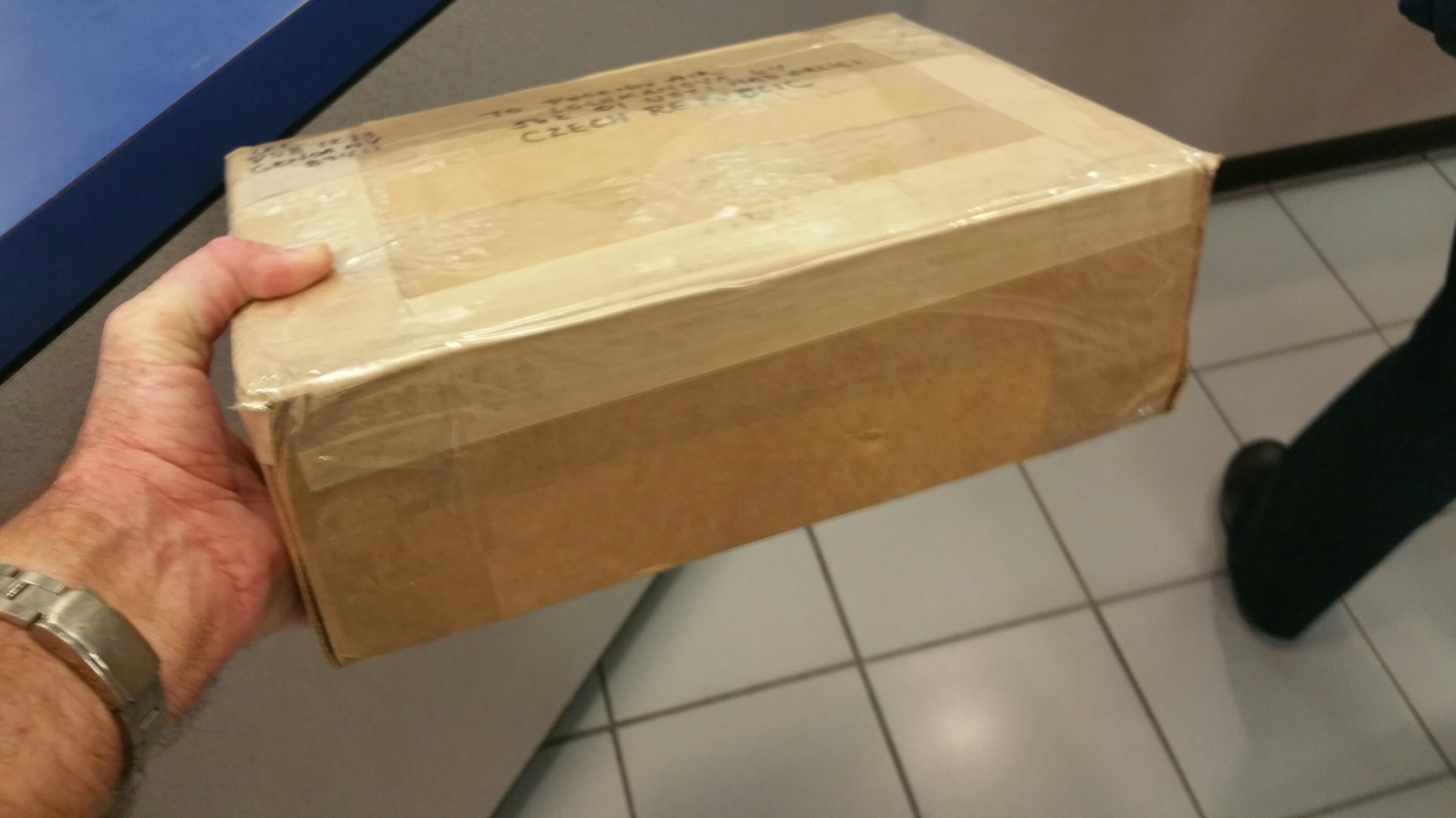

sheridan9sc Posted November 2, 2018 Report Posted November 2, 2018 Just sent off our parachute this morning for repacking to Dennis at Magnum Parachutes. Thank you to Ed for the clear instructions on removing the chute from the plane. USPS 3-day delivery from South Carolina to Florida was $37 plus $2,000 insurance of $27. The insurance was probably unnecessary, but it gives piece of mind and since Dennis bundles these back to Czechoslovakia the valuation does not go directly on the customs forms.. I used a box from UPS that was 20 x 12 x 12 ($5). I have attached the instructions from Dennis so that you have all the pictures requested when you are removing the chute. I'll update this post once I get the chute back. Magnum, Repack Shipping Instructions.docx Quote

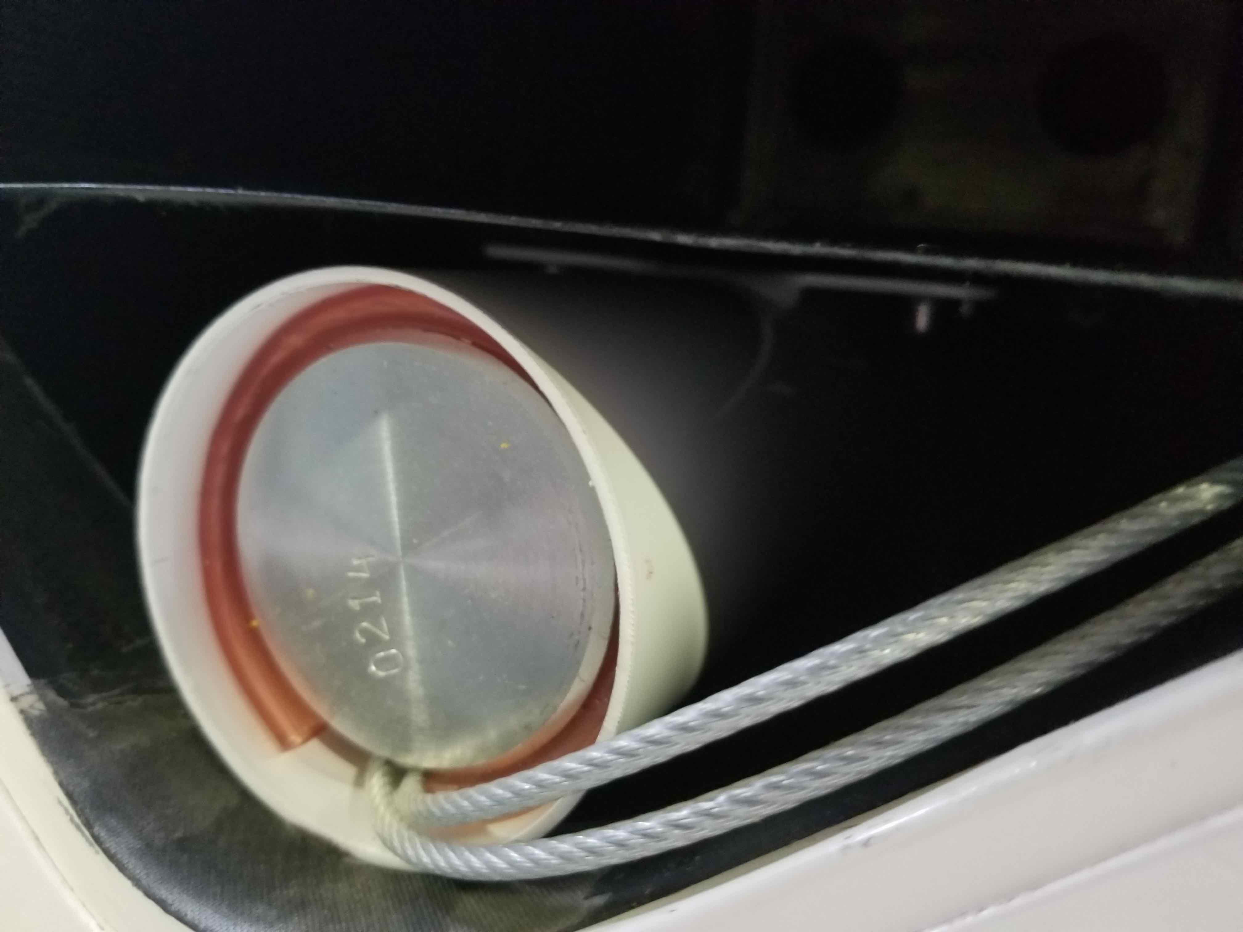

sheridan9sc Posted January 9, 2019 Report Posted January 9, 2019 Here is the follow-up to my previous post. Parachute was returned to me on December 17, so about six weeks from shipment. Cost was $395 for the repack and $400 for the shipping to and from Czechoslovakia and back to me. Total cost, $860. I never got Dennis' photo listed in the instructions, but essentially you are only sending the softpack with the parachute itself. While Dennis needs the pictures of the cable in your plane in full resolution, I will attach reduced resolution shots here. All pictures in series 1 are taken inside the plane from various uncomfortable positions. Picture 1a is taken in selfie mode because it is behind the black, carbon fiber box you see in the top left of 1b (you will need an extra light source to illuminate the connection with the rocket). Picture 1d is under the instrument panel. Picture 4 is view from the top of the airplane looking down into the end of the rocket. Don't know if he needed all of the pictures in series 1, but these views were sufficient for him. All in all, the most difficult part is getting the parachute in and out of the plane! Quote
