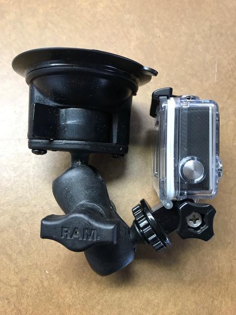

edwalker Posted November 25, 2017 Report Posted November 25, 2017 Hi, Eric - Here's an alternative idea. I think it's worth considering what you want the videos for before choosing a mounting spot. To be honest, I don't really care for the tail and wing mounted videos all that much. The great value I see, as an educator, is being able to replay a flight and think about what I might have done differently if I could do it over. The videos that I like the most are those with in-cockpit visibility of the instruments and, even better, a narration to capture the decision making processes by the pilot. Bruno Vassal has several of these as good examples of ride-along teaching videos. Here's how I mount my GoPro. It uses 2 RamMount items that mount to the canopy at pilot eye level, just near the canopy handle. I also use a cable from Nflightcam which allows audio from the headsets and extra power from a USB battery pack. Note, however, and Nflightcam is very clear about this, you cannot use ship's power, only a USB battery pack. I spent several hours trying to filter the onboard DC with all sorts of audio transformer filters, and it is just impossible to remove the whining ground loop. I don't know of anyone who has successfully done this, but since I'm just a ham radio operator and you're an official electrical engineer, you may have more luck. Here's a video snippet of practicing a no-spoiler approach to let you see the angle. The camera is mounted midline. I've since moved it to the right a bit. Ed GoPro test.mp4 Quote
