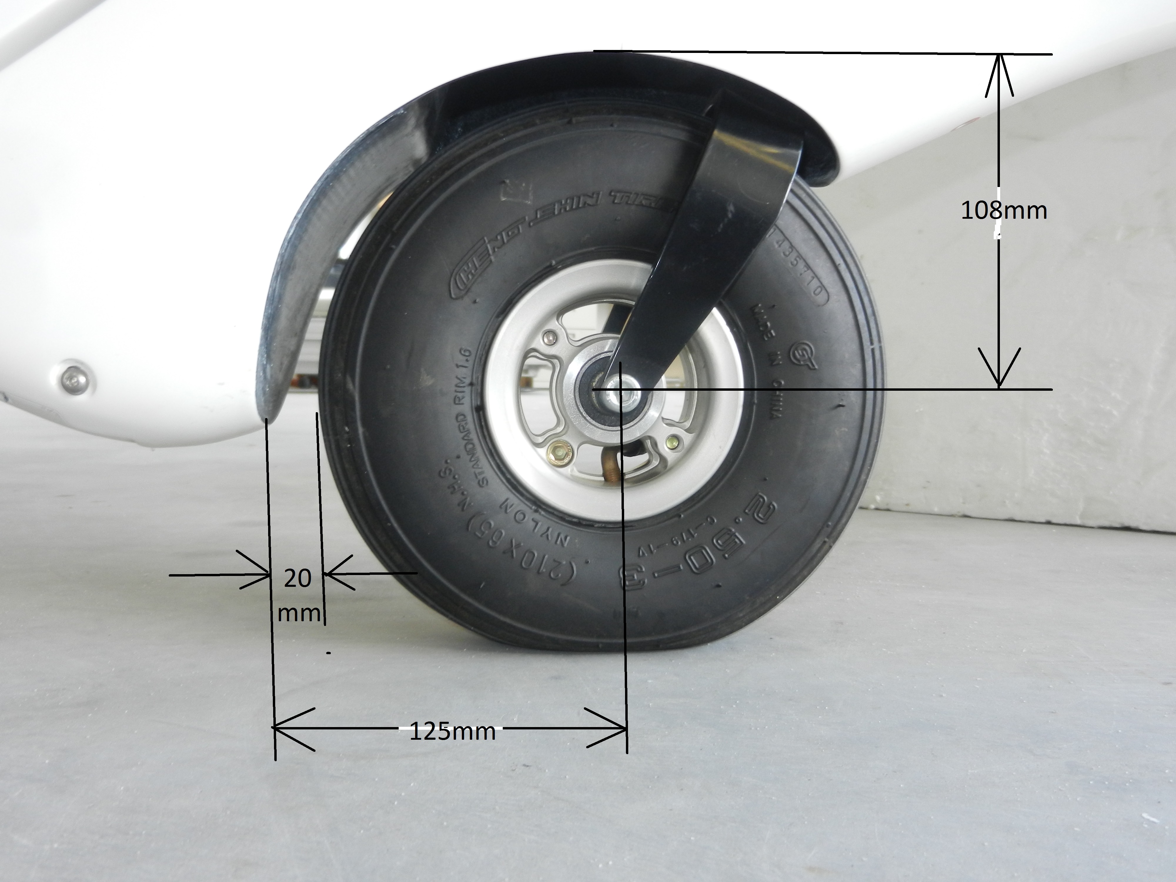

The rudder pedal to turnbuckle to cable to rudder in the Phoenix is a very simple and common arrangement shared by many types of aircraft.  What is not common is the dual steel rod connection to the tailwheel bracket, each of which can negatively impact the action of the rudder or tailwheel if damaged.  Taken as individual parts, it is easy to examine all of the parts that impact the rudder and the tailwheel and determine if the action is free and correct.  If the tailwheel bracket is bent or broken, it can produce the scenario which Farhad describes.  In fact, this has happened to another Phoenix exactly as Farhad describes.  When the bent tailwheel bracket was replaced the reduction of control on the ground was solved.
Farhad's suggestion to check your rudder for full deflection is right on, and should be part of every pre-flight inspection.  But take this one step further and examine your tailwheel in detail (not on every preflight, but the next time at the airport).  Put your aft fuselage on a padded 2' high block.  Use a creeper or lay on your back, and use a powerful flashlight to examine the tailwheel, the tailwheel bracket, and the two steel rods which connect the tailwheel bracket to the rudder.  Move the rudder to full extension.  Look at the rudder deflection decal and confirm that the rudder moves fully as indicated on the decal.  Have someone sit in the cockpit and move the rudder pedals to full extension and note the rudder deflection on the decal.  Have your A&P or LSRM do this at every annual inspection.   However!  We have learned that it is difficult or impossible to detect a bent tailwheel bracket unless it is removed from the plane.  If you have a hard tail strike, it is imperative that you remove the tailwheel and bracket for close examination.
