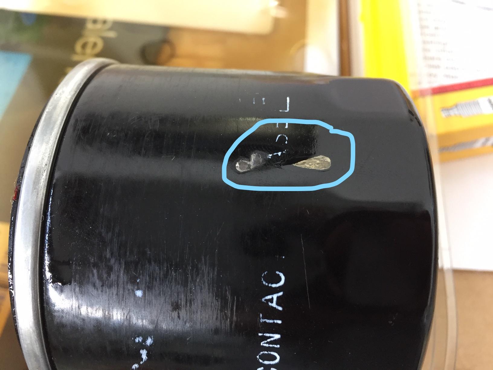

Recently, I noticed oil spatters on the under side of the fuselage, between the firewall and the landing. Eventually, I discovered the oil was coming from a tiny hole in the side of the oil filter that faces down. Note this filter is shown off the engine.

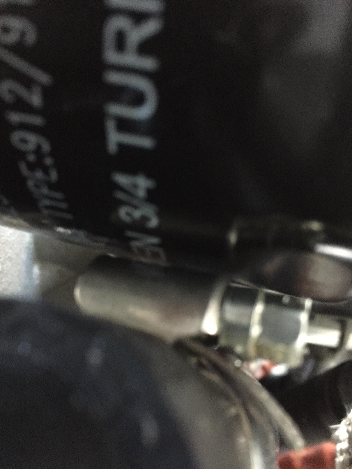

The hole was caused by the upper left hose clamp on the radiator, vibrating against the filter when the engine ran.
The hose clamp was rotated 180 degrees and retightened, so the clamp's gear housing was below the hose, which is the original, factory position for the clamp. A new oil filter was installed.
How can this happen? In my case, the clamp position was inadvertently changed during the 5 year "rubber replacement". It's a easy mistake to make, because when the cowling is off,  it allow's the radiator to hang down with about 2" of room between the clamp and filter. I suggest all owners check the clamp position, especially if they've had a rubber replacement.
